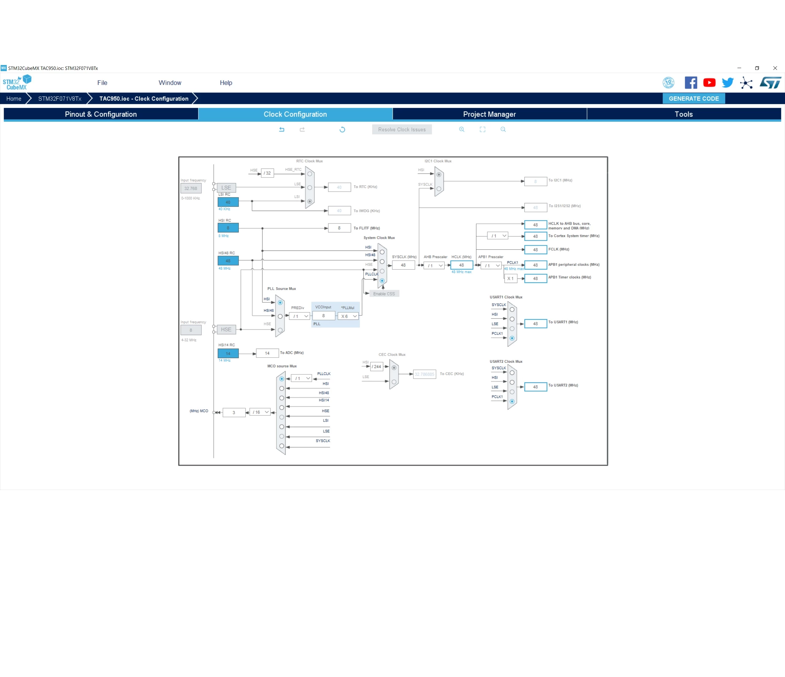

vasilevskialeksandar
March 6, 2020
My mistake, I tried to find explanation for wrong baudrate in wrong place.
After your suggestion i rechecked usart settings and value of baudrate registers.
Values are good for 48MHz PCLK. But when I measured SYSCLK and PLLCLK using MCO output with scope
I am seeing value that corresponds to 24MHz pll clock.
Is HSI clock source with /1Prediv and x6 for PLLMul valid combination to get 48MHz SYSCLK?
I have attached screenshot of clock configuration window.
On MCO I measure 1,5Mhz instead of 3MHz as configuration window shows.
Any ideas what I need to check?
Mike_ST
March 6, 2020
Glad you are going forward,
Your config should be ok.
About 1.5MHz on MCO check that your are not calling  HAL_RCC_MCOConfig(RCC_MCO, RCC_MCO1SOURCE_PLLCLK_DIV2, RCC_MCODIV_16);
or  HAL_RCC_MCOConfig(RCC_MCO, RCC_MCO1SOURCE_PLLCLK, RCC_MCODIV_32);
instead of  HAL_RCC_MCOConfig(RCC_MCO, RCC_MCO1SOURCE_PLLCLK, RCC_MCODIV_16);
March 6, 2020
Problem is that HAL_RCC_OscConfig function returns HAL ERROR.
RCC->CFGR has a value 0x0010000A
RCC->CFGR2 has a value 0.
How it ends in this error I need to investigate.
This sentence from manual (page 111) explains PLLSRC[1:0]
00: HSI/2 selected as PLL input clock (PREDIV forced to divide by 2 on STM32F04x, STM32F07x and STM32F09x devices)
This div by two is not shown in Clock configuration window. Don't know if it is taken into calculation in STM32cubeMX windows software.
Now I will read document details and will try to find explanation for lower PLLCLK than expected.

Mike_ST
March 6, 2020
That's possible. I have entered a ticket.
