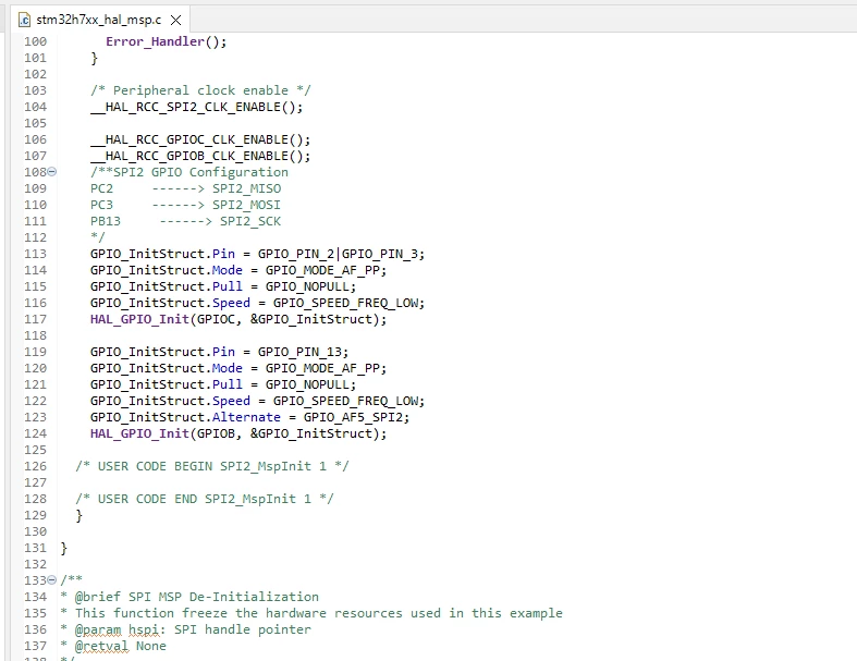

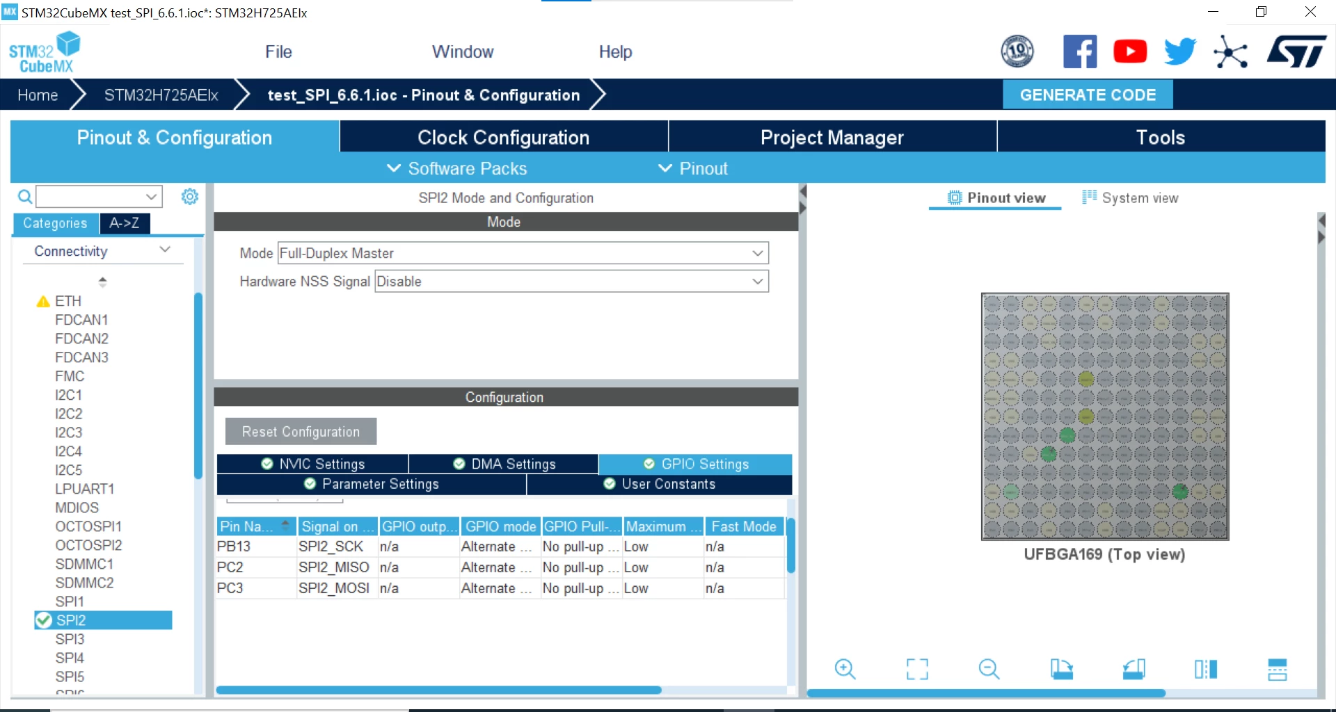

I tried to generate code with CubeMX for my project. I set up SPI2 as Full-Duplex Master without hardware NSS with the follwing pin config:
- SCK: PB13
- MISO: PC2
- MOSI: PC3

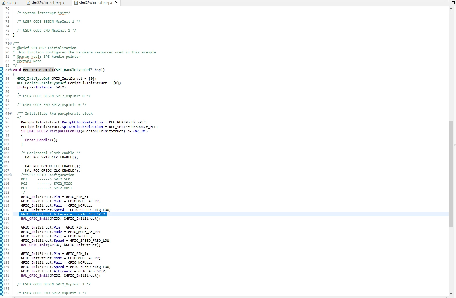

The code generated in `void HAL_SPI_MspInit(SPI_HandleTypeDef* spiHandle)` looks like the following for MOSI and MISO:
GPIO_InitStruct.Pin = SPI_MISO_Pin|SPI_MOSI_Pin;
GPIO_InitStruct.Speed = GPIO_SPEED_FREQ_MEDIUM;
HAL_GPIO_Init(GPIOC, &GPIO_InitStruct);Although it should look like that:
GPIO_InitStruct.Alternate = GPIO_AF5_SPI2;
HAL_GPIO_Init(GPIOC, &GPIO_InitStruct);=> The configuration for `Alternate` is missing!
With the generated code, the MOSI and MISO lines do not work at all, while the SCK is doing its thing. After the fix they work like a charm.
