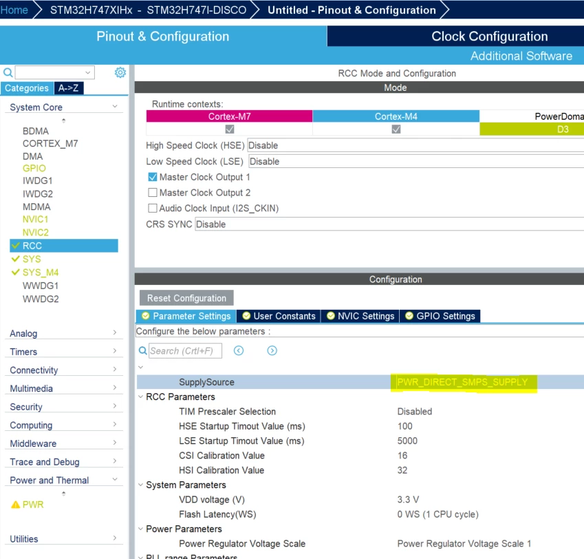

Mismatch STM32H747I-DISCO board configuration in STM32CubeMX .
As per the section 5.2.3 of the STM32H747I-DISCO board user manual, the default configuration of the hardware is to use SMPS mode but the default mode generated by STM32CubeMX when you select STM32H747I-DISCO board is LDO. Because of this mismatch, the board is bricked.
ST should have used the same power supply configuration in both the hardware board and default CubeMX configuration.

Khouloud ZEMMELI
Oct 10, 2019 8:09 AM UTC
​Hello @ramkumarkoppu​ ,
Thanks for your feedback,
CubeMX gives you the choice to choose which supply source you like , so  you can change this parameter under RCC configuration .
Best regards,
Khouloud
ramkumarkoppu
Oct 10, 2019 8:13 AM UTC
Hi @Khouloud ZEMMELI​ There is no option in CubeMX specifically for PWR_DIRECT_SMPS_SUPPLY.
Khouloud ZEMMELI
Khouloud ZEMMELIBest answer
Oct 10, 2019 9:11 AM UTC
​You're right @ramkumarkoppu​ this issue has been fixed and it will be available in the 5.4.0 CubeMX version.
Best regards,
Khouloud.
