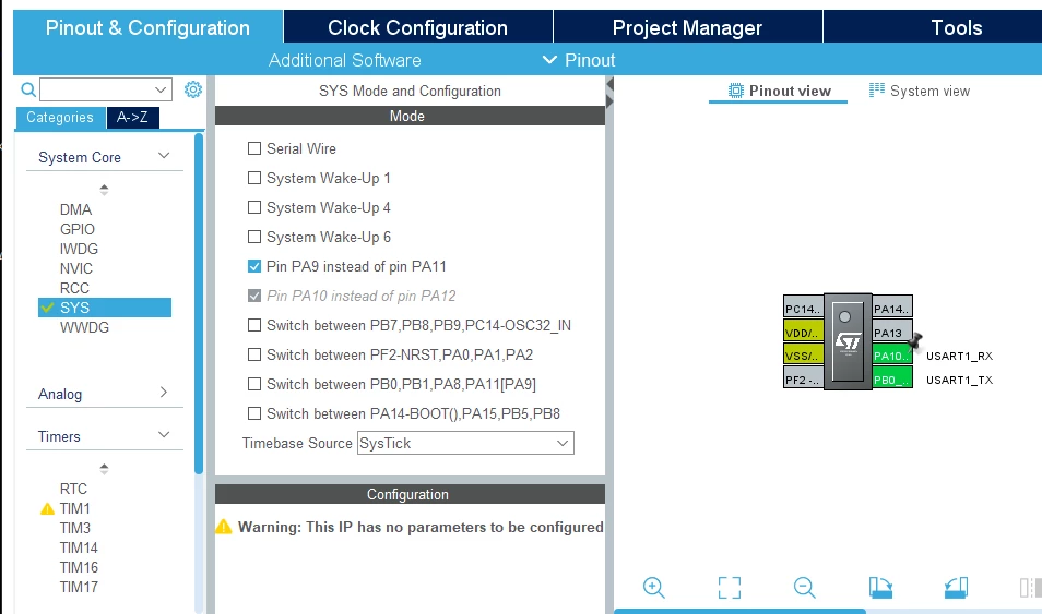

I am interested in how many USART modules are available in the STM32G030J6.
Datasheet contains contradictions.
According to table 12 (pages 32-34) we get the following:
USART1_TX 8 pin
USART1_RX 1 pin
USART2_TX 4 pin
USART2_RX 8 pin
According to Figure 6 (page 30) and Table 13 (page 35) we get the following:
USART1_TX 5 pin
USART1_RX 1 pin
USART2_TX 4 pin
USART2_RX 8 pin
STM32CubeMX indicates that only USART1 is available.
How right?

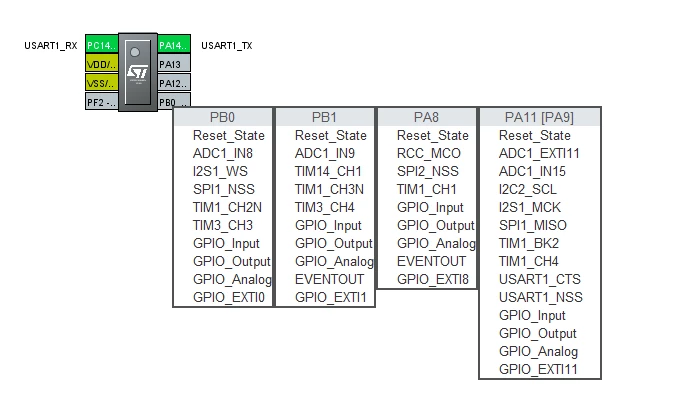

Hi. Only one USART in the STM32G030J6. Pin "PA8/PA11[PA9]/PB0/PB1" don`t have  USART1_TX.
AShap.5
AShap.5Author
September 2, 2019

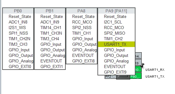

STM32CubeMX make this:
Pin "PA8/PA11[PA9]/PB0/PB1" have USART1_TX
How right?

AShap.5
AShap.5Author
September 3, 2019
Last version - 5.3.0

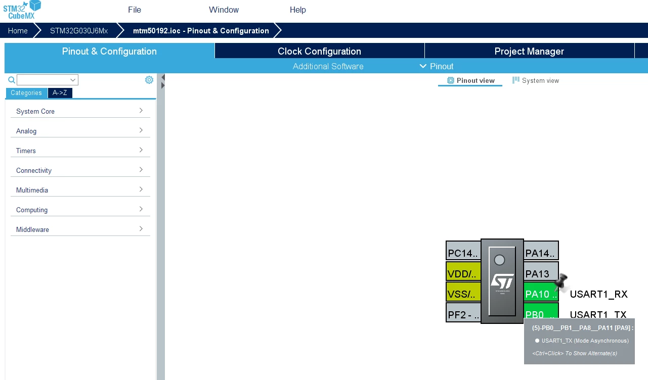

1st step:
2nd step
Amel NASRI
September 26, 2019
Hello @AShap.5​ ,
This seems to be a limitation on STM32CubeMX side as it is possible to use USART2 on pins 4 and 8 of STM32G030Jx SO8N package.
This will be reported to our STM32CubeMX team.
-Amel
Nesrine.JLASSI
Visitor II
September 30, 2019
Hello @AShap.5​
Thanks for the feedback,
 It will be fixed in the next CubeMX release.
Regards,
Nesrine
