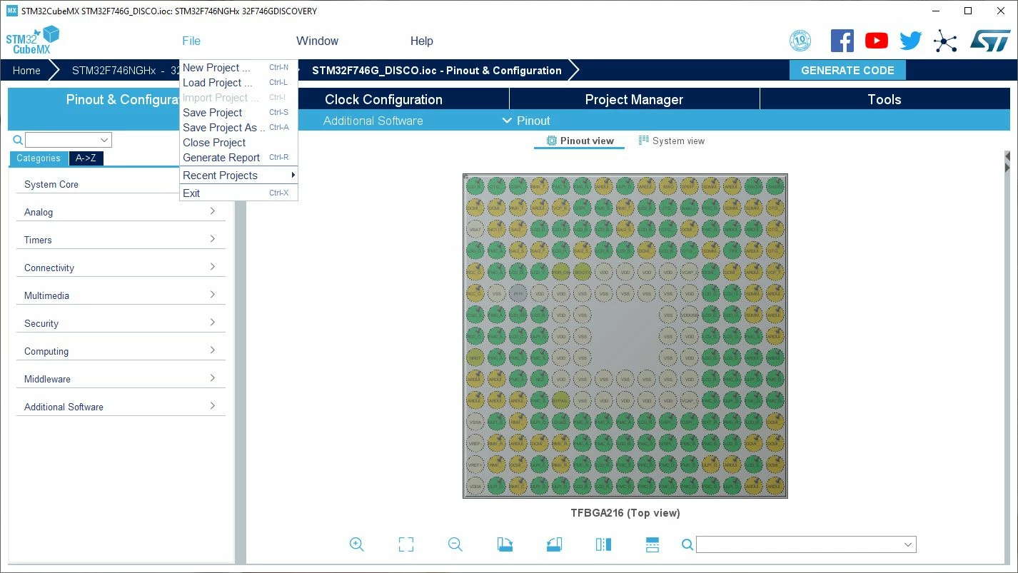

I'm using 5.5.0 and want to import a 5.4.0 project but the Import Project is grayed out. This is a fresh install

Hello @Community member​
Import do work only on a fresh loaded MCU, importing on a configured MCU (like in the screenshot) will be available in a future release of MX

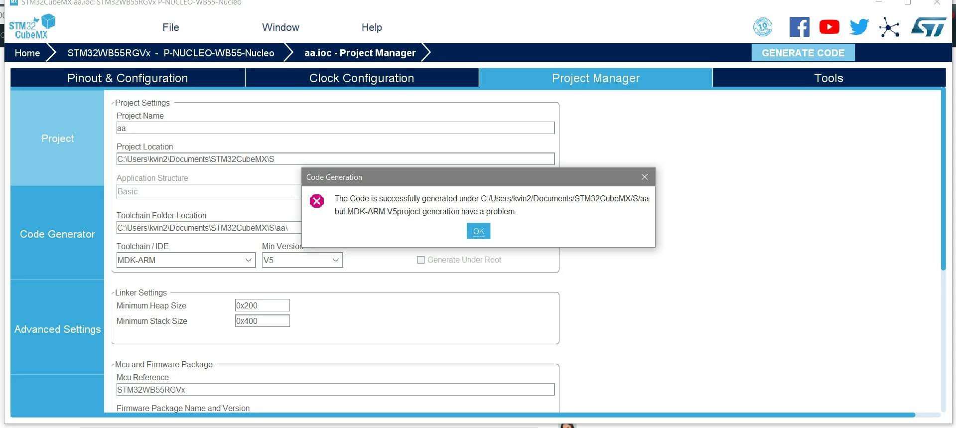

I firstly removed the 5.5.0 which was installed via update tools and then install 5.5.0. However, it still failed to generate the project.0690X00000D9kegQAB.png
Aymen CHAKROUN
February 25, 2020
I guess you are using Java13. If yes, please remove this version and install at least Java11 or Java8. We found an issue with Java13/Keil IDE, this issue is not related to STM32CubeMX upgrade process.
For info: STM32CubeMX is not yet validated/tested with Java13.

The new 5.6.0 with Java 8 still has the same error.​
