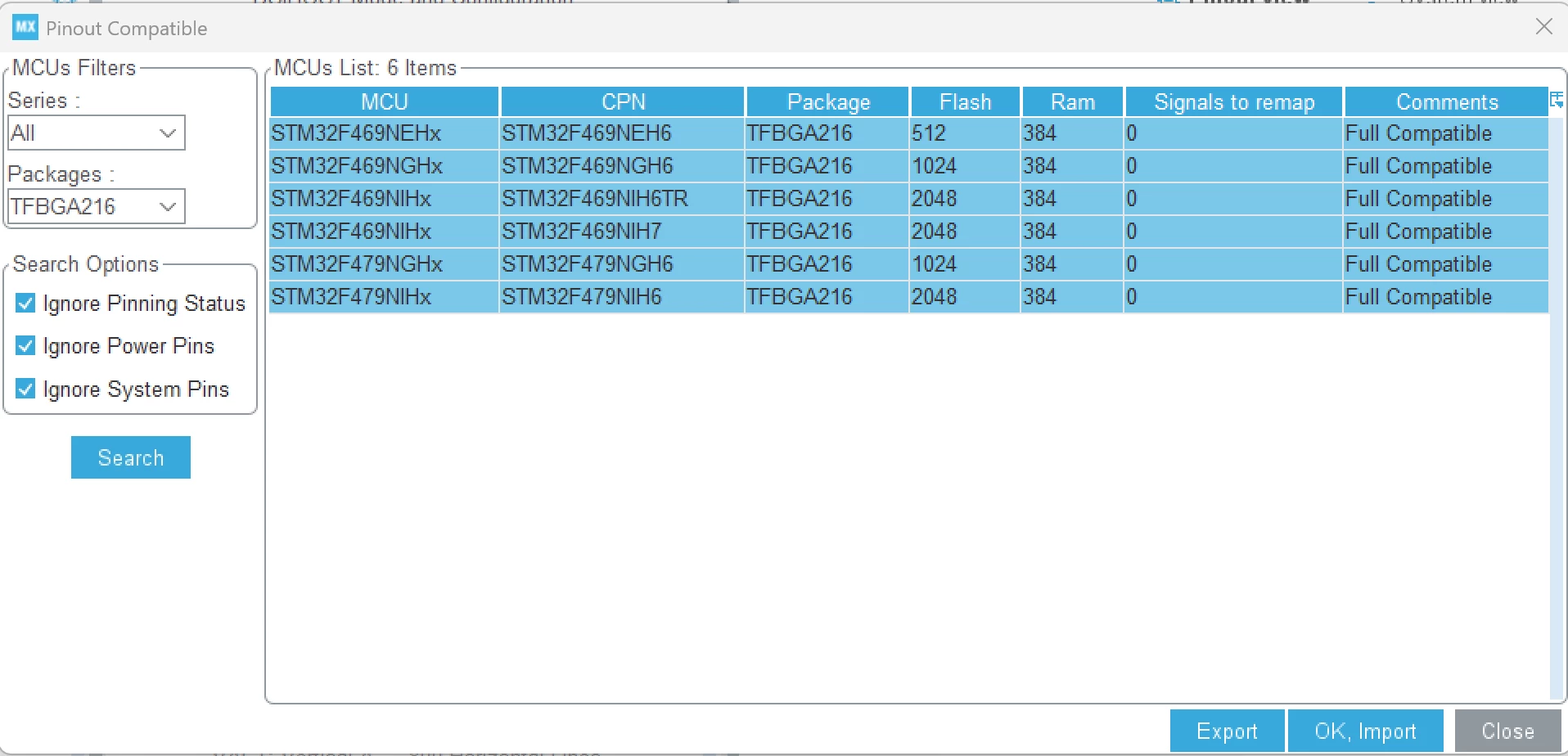

This is the list of pinout compatible devices that I am seeing.
Aargh! I made a mistake in my post, I'm actually trying to migrate from STM32F469NIH6 to STM32F769NIH6, the question remains the same, these two MCU's appear to have the same pinout but don't show in STM32CUBEMX.

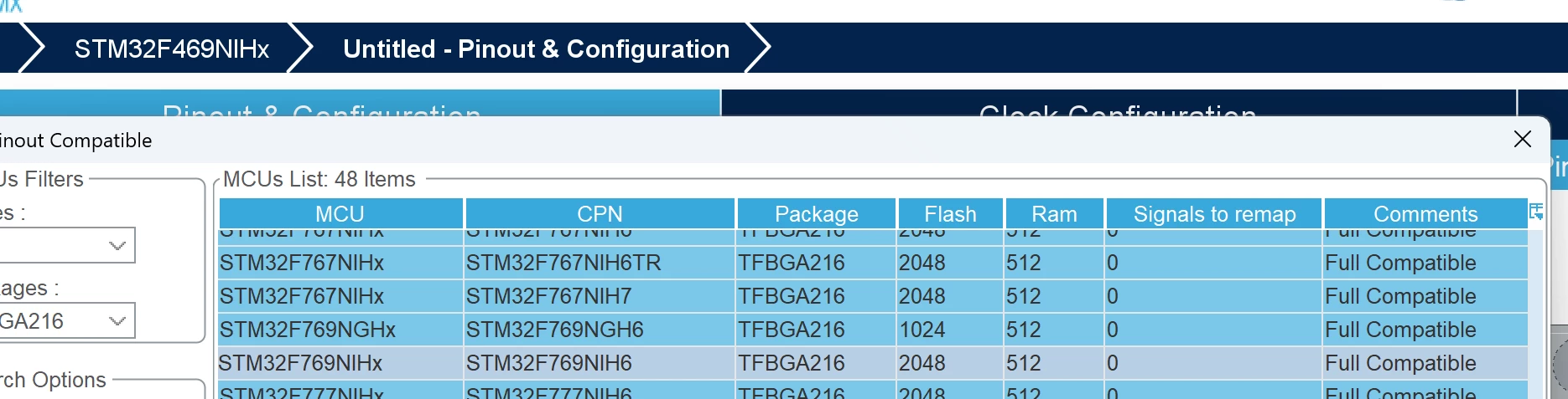

STM32F769NIH is listed as pinout compatible to STM32F469NIH for me:

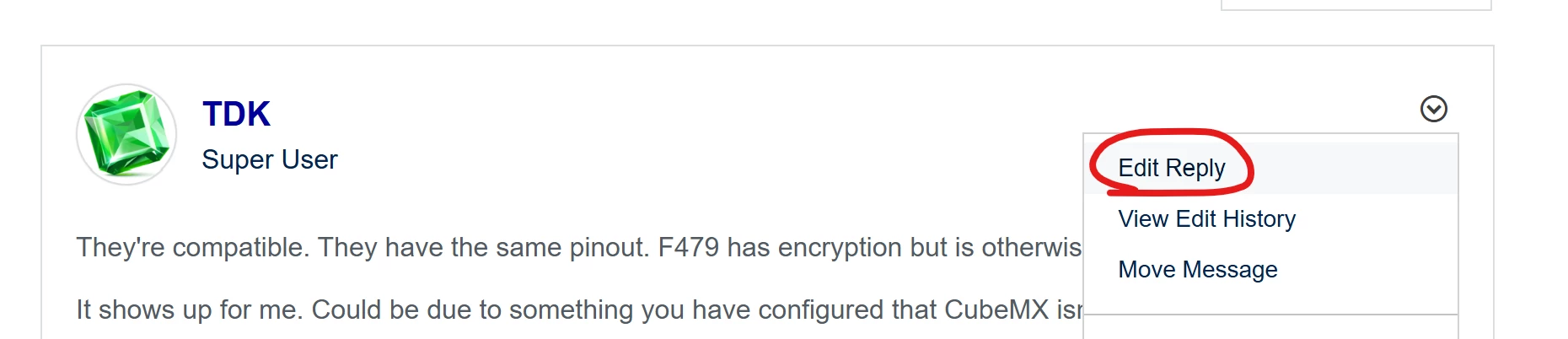

You can edit your posts with the down arrow in the top-right to correct incorrect information. Helps to proofread before you hit submit. I don't know why part numbers have "typos" in so many people's posts. It is frustrating putting effort into questions that simultaneously (a) exactly what the user asked and (b) not what the user wants.
Hello @TDK, thanks for pointing out the down arrow edit facility, I didn't know this.
Thank you for taking the time to post your previous reply and I apologise for my mistake, however the information that you have provided will I am sure be helpful to someone.

@RobNewbury  when you use STM32F469I-DISCO board and selects the "MCU List Compatible" option only six items listed as compatible MCUs
@TDK   when you use MCU : STM32F469NIHx and selects the "MCU List Compatible" option  ,48 Items appears and STM32F769NIH6 is one of the compatible MCU
A support ticket (ID: 220514) has been raised to investigate why does this difference in behavior occur?
