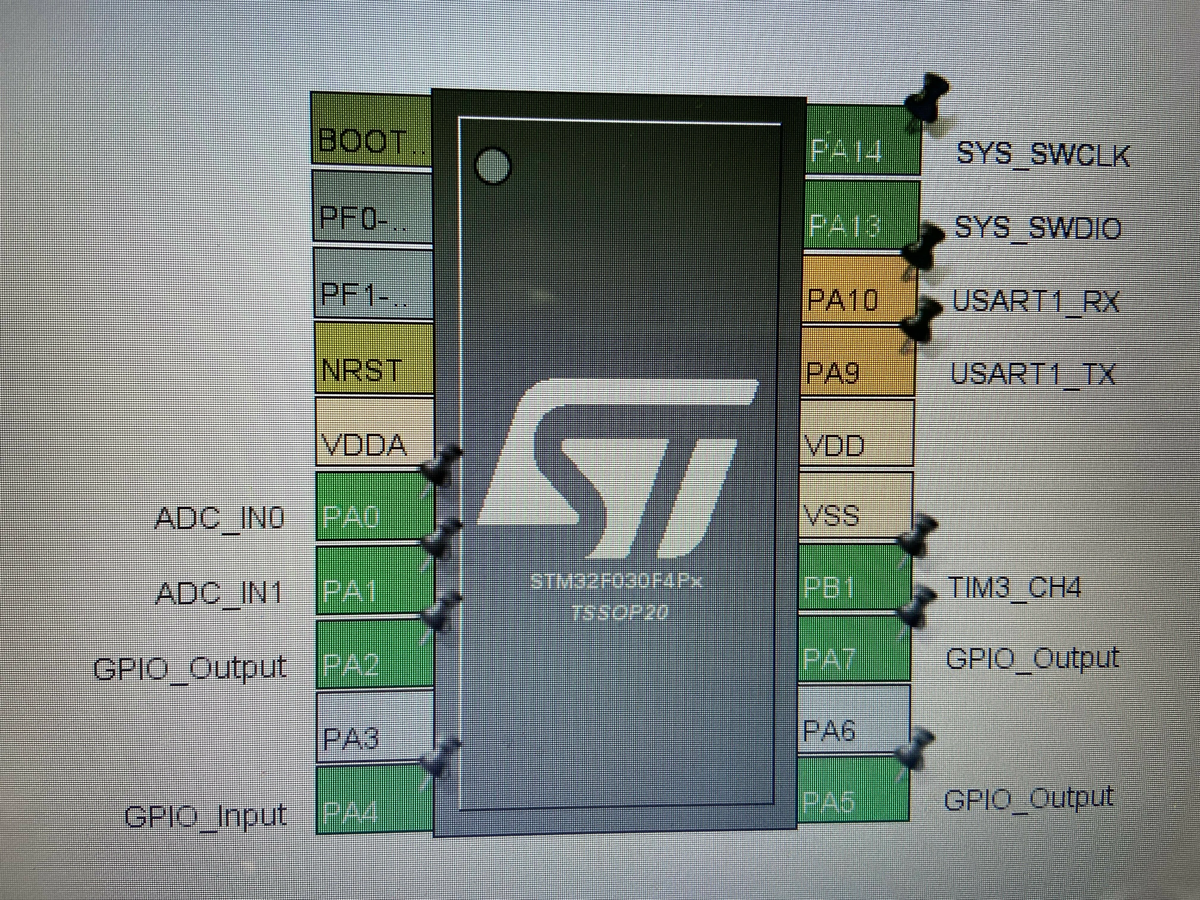

Hello, it looks like PA2 is not connected to any PWM timer.
You could programm a (software) PWM using interruptions and toggling up and down the GPIO

can you use another pin?(maybe PA4)
What software are you using for developing in your PC?

YES ,I use cubeMX for the configuration
but ,hardware is ready ,so i can't switch.
JLEE.1706
JLEE.1706Author
Nov 27, 2019 12:19 PM UTC
you can see the picture , now pwm out is PB1
but i want switch to PA2
Javierio
Nov 27, 2019 12:24 PM UTC
there is no PWM functionality in PA2.
PWM functionality is a feature some specific pins have, (because they can be connected to the timmer pwm outputs).
If the pin you want to use doesnt have that access to the pwm timmer function you need to create your own pwm thing.
How to do it:
Select your timmer in cubeMX, start the timmer as compare and match interruption.
Inside the ISR(interruption function) of the timmer you just configured put some gpio_toggle function or counters.
The rest is just playing around with it
