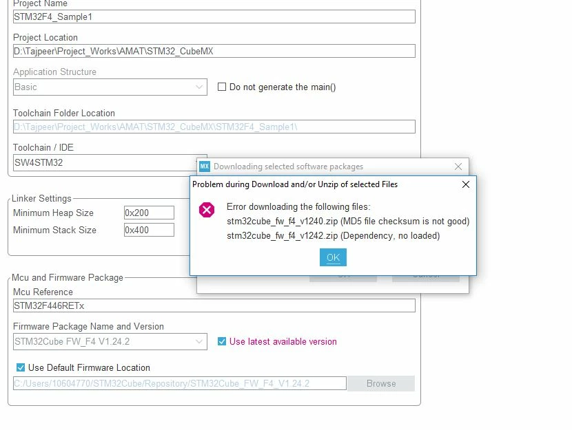

MCU and Firmware package error while trying to generate the code using STM32CubeMX software

Hello @TH.16.336​
Please tell me which CubeMX version did you use.
I tried with the lasted CubeMX version(5.5.0) and it works correctly.

I am also using version 5.5.0.
Issue is with the network settings. If I download the package and give that repository path, then it's working fine.
But package downloading is not happening through CubeMX.
