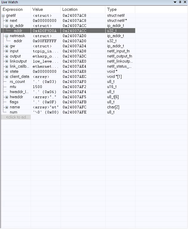

This code works well and I am able to get an IP address (I can determine it frome the gnetif->ip_addr field), I can see all the proper ARP request in WireShark and I am able to ping the device:
Herein, I am filtering only the traffic from/to the appropriate (STM32) MAC address 00:80:E1:00:00:00.

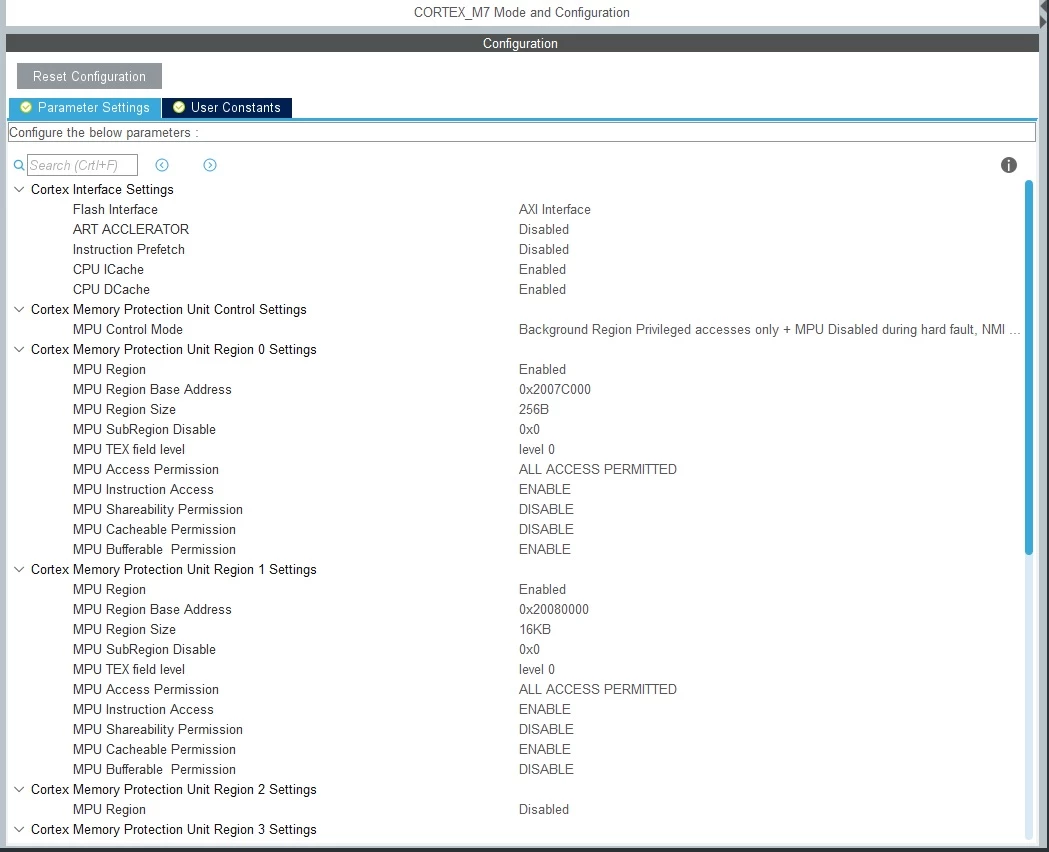

October 3, 2018
Copying the entire void MPU_Config(void) routine seemed to do the trick. Thanks!
I would suggest adding a warning in STM32CubeMX that MPU needs to be enabled and properly configured for ETH to work (I guess it could even generate the necessary code snippet). Because right now it informs only about the RAM pointers, PHY drivers, and DCache.

Visitor II
February 27, 2019
Hi @KR​
I apologize for the delay and I have the honor to inform you that I finally had a solution to run the LWIP on H7
1- You must activate the MPU control mode in Background Region Access Not Allowed + MPU Disabled during hard fault, NMI and FAULTMASK handlers
2- You must configure the region 0 and 1 according to the configuration found in the code
You will find a screen print for the simulation and generate code
I will remain at your disposal for any other questions.

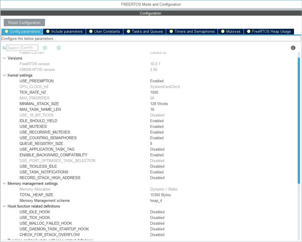

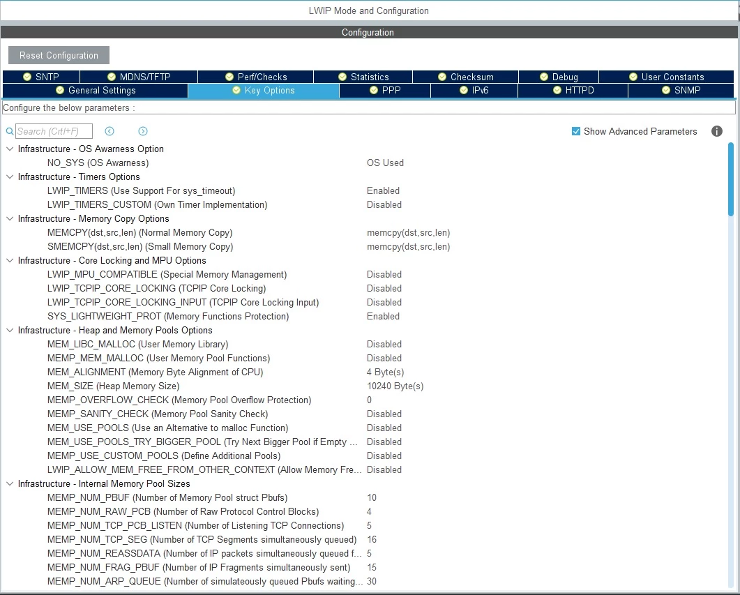

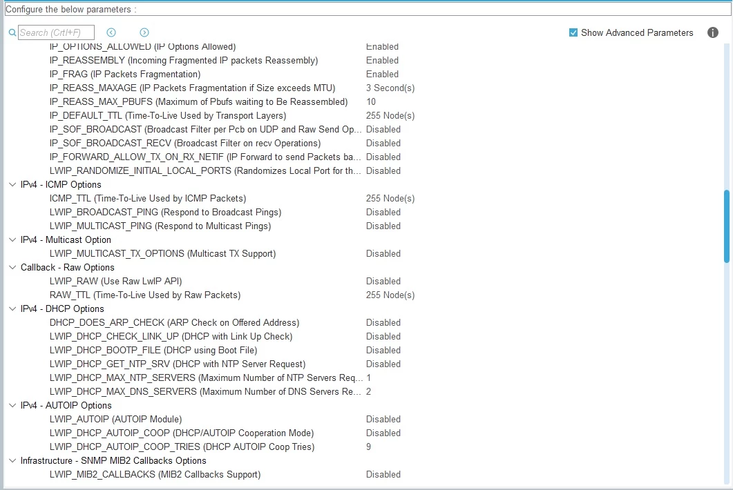

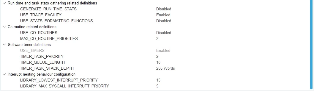

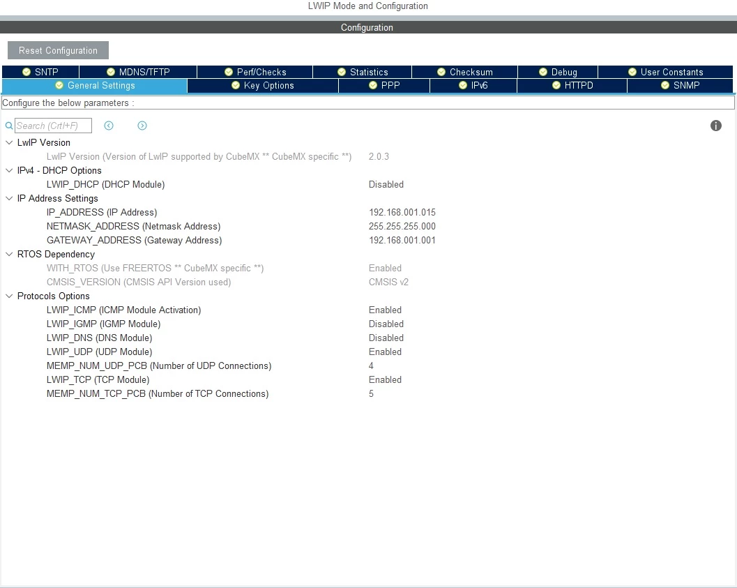

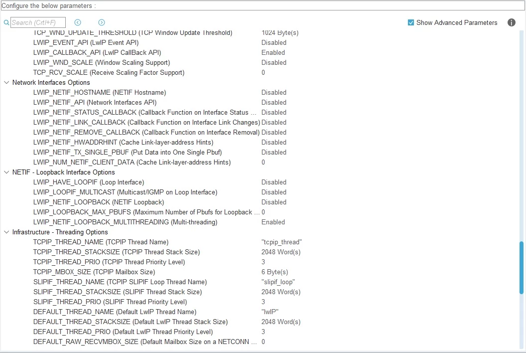

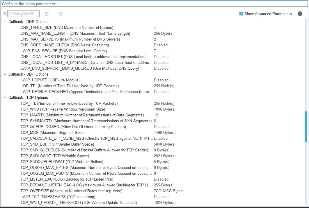

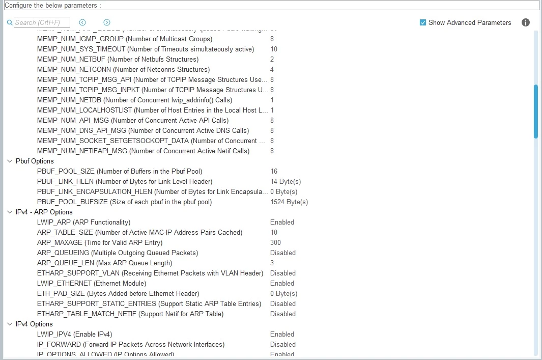

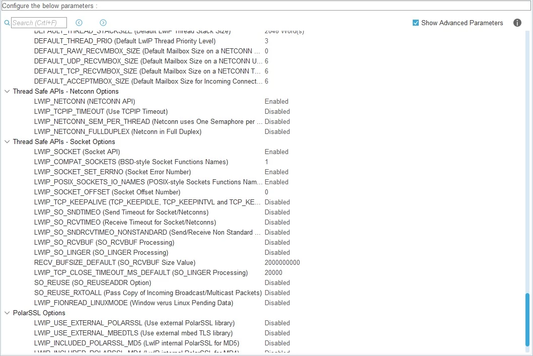

KFili
Visitor II
December 15, 2019
Hi everybody and @WBOUG​
I tried to use LwIP_HTTP_Server_Netconn_RTOS example on STM32CubeIDE. (STM32F767ZI-NUCLEO BOARD) but it could not run properly.
it works for 2 mins then stucks. (Sometimes it effects the other tasks sometimes it doesn't)
I share all configurations' screenshots.
I would be grateful if you show me where I have the mistake.

 MPU_InitStruct.AccessPermission = MPU_REGION_FULL_ACCESS;
 MPU_InitStruct.DisableExec = MPU_INSTRUCTION_ACCESS_ENABLE;
 MPU_InitStruct.IsShareable = MPU_ACCESS_NOT_SHAREABLE;
 MPU_InitStruct.IsCacheable = MPU_ACCESS_NOT_CACHEABLE;
 MPU_InitStruct.IsBufferable = MPU_ACCESS_BUFFERABLE;
 HAL_MPU_ConfigRegion(&MPU_InitStruct);
 /** Initializes and configures the Region and the memory to be protected
 MPU_InitStruct.Enable = MPU_REGION_ENABLE;
 MPU_InitStruct.Number = MPU_REGION_NUMBER1;
 MPU_InitStruct.BaseAddress = 0x20080000;
 MPU_InitStruct.Size = MPU_REGION_SIZE_16KB;
 MPU_InitStruct.SubRegionDisable = 0x0;
 MPU_InitStruct.TypeExtField = MPU_TEX_LEVEL0;
 MPU_InitStruct.IsCacheable = MPU_ACCESS_CACHEABLE;
 MPU_InitStruct.IsBufferable = MPU_ACCESS_NOT_BUFFERABLE;
 /* Enables the MPU */
 HAL_MPU_Enable(MPU_PRIVILEGED_DEFAULT);
