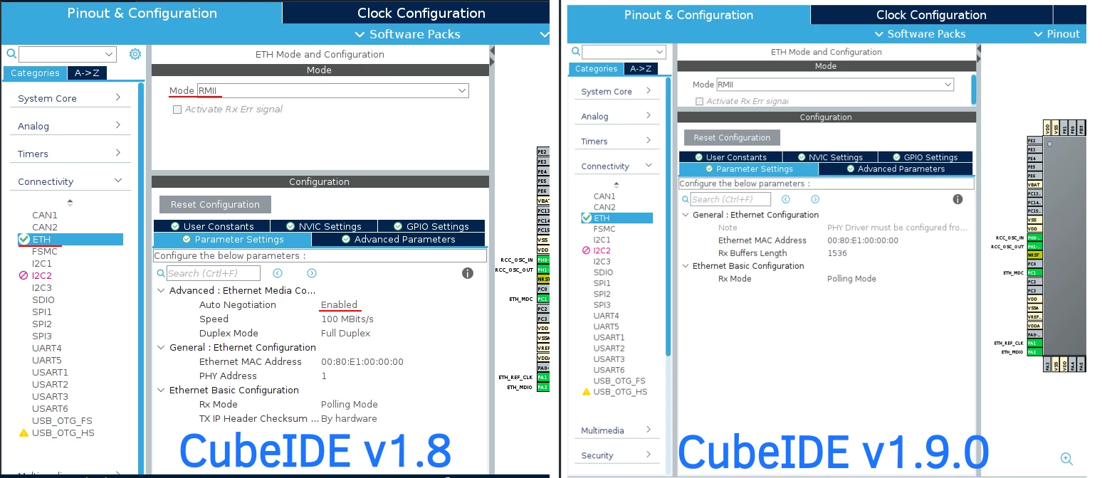

Hi I moved a code that was working on STM32CubeIDE v1.8. But after update STM32CubeIDE v1.9 I am facing a new issue that I have never see before in STM32CubeIDE v1.8.0!
I compared what was before and what we have now, see screen...

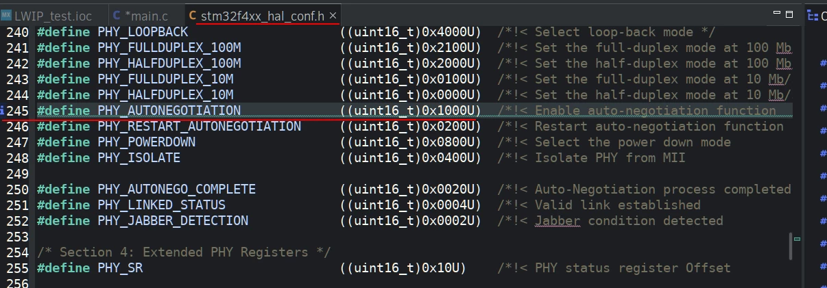

Maybe to me need only turn on "Auto Negotiation" in main.c and ping will start working but, I don't know how to do it?
Could someone tell me why code do not initialize MX_LWIP_INIT (); ?

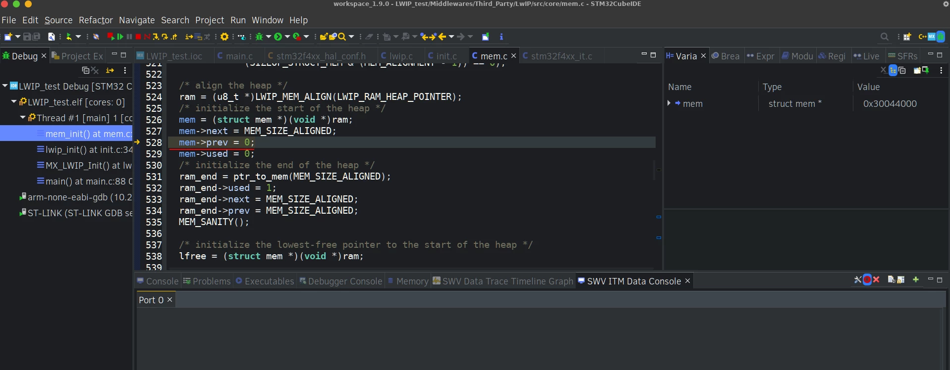

Should look at the LWIP_RAM_HEAP_POINTER definition
0x30044000 doesn't strike me as a valid RAM region in the STM32F4 devices.
Make sure it's building for the right target

No, I was wrong when I thought that to me need just activate "Auto Negotiation" it is already activated in stm32f4xx_hal_conf.h
Any ideas?

>>Any ideas?
Hard Faults, diagnose what's actually causing it, and work the issue from there.
Look at the faulting instructions/code, see what it is doing.
Faulting in random locations, perhaps look at interrupts, handlers, call-backs.
Faulting in the same place, likely errant pointers, memory usages or corruption.
Check stack

How to find out what's actually causing it?
I'm debugging it and it write to my nothing.
After the underlined line on attached screen code immediately flies into "void HardFault_Handler(void)"
