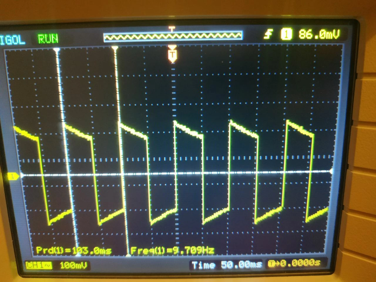

Hi, I'm new with stm32 and I want to get a simple 1Hz square wave in a NUCLEO-F446RE using CubeMX for the initial config. The code is so simple that I can't figure out where the problem is.
I just do:
 while (1)
	 HAL_GPIO_TogglePin(GPIOA, GPIO_PIN_8);
	 HAL_Delay(500);
and my GPIO configuration:
 /* GPIO Ports Clock Enable */
 __HAL_RCC_GPIOC_CLK_ENABLE();
 __HAL_RCC_GPIOH_CLK_ENABLE();
 __HAL_RCC_GPIOA_CLK_ENABLE();
 __HAL_RCC_GPIOB_CLK_ENABLE();
 HAL_GPIO_WritePin(GPIOA, LD2_Pin|GPIO_PIN_8, GPIO_PIN_RESET);
 /*Configure GPIO pin : B1_Pin */
 GPIO_InitStruct.Pin = B1_Pin;
 GPIO_InitStruct.Mode = GPIO_MODE_IT_FALLING;
 HAL_GPIO_Init(B1_GPIO_Port, &GPIO_InitStruct);
 /*Configure GPIO pins : LD2_Pin PA8 */
 GPIO_InitStruct.Pin = LD2_Pin|GPIO_PIN_8;
 HAL_GPIO_Init(GPIOA, &GPIO_InitStruct);

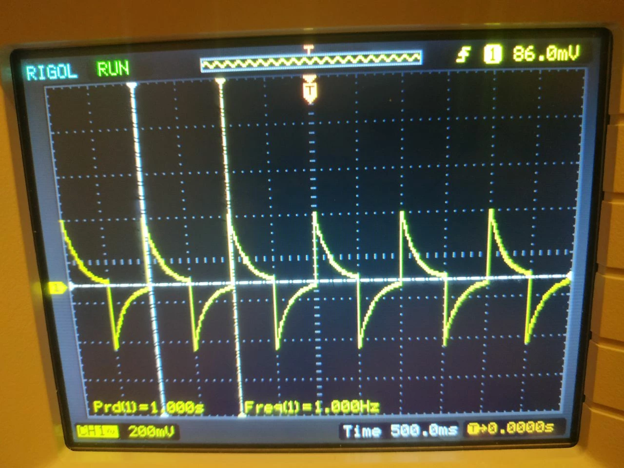

But the signal I get:
As I've seen, that distortion is not that big if I increase the frequency:
But still there. What's going on???
Thanks!

Is it April 1? You are kidding , right? Coupling should be DC, not AC.

I knew it had to be something very stupid but not that much! :face_with_tears_of_joy: thanks!!
