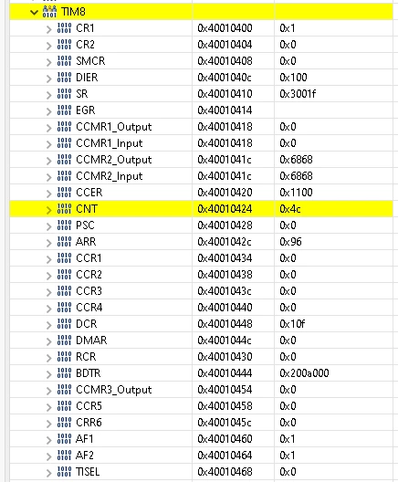

I can see the "Dbg" pin changing state at 10Hz, however the Timer8 CCR3 and CCR4 are always at 0.
In the debug window, if I change the CCR3 and CCR4 registers, then yes I can see a PWM output

The cache is disabled (I figure it would save some troubles):
0693W00000GYfqtQAD.pngYes, if I set the CCRx register to some value, it stays there (hence my suspicion that the DMA is not writing into the register)

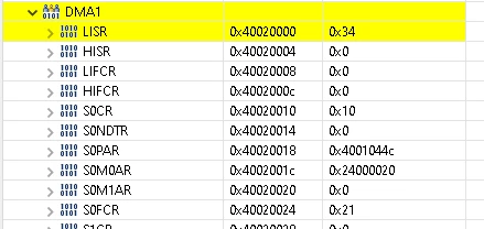

My DMA settings:
0693W00000GYg2aQAD.pngThere is no transfer error, just the DMEIF0 which is described to be set "when a DMA request occurs when the previous data has not yet been fully transferred", which is odd because there is nothing else running or using the memory bus.

Nov 24, 2021 2:50 PM UTC
Both S0CR=0x10 and S0NDTR=0 are wrong.

MDega.2AuthorBest answer
Nov 24, 2021 3:41 PM UTC
Hi Jan,
Those registers were initialized from CubeMx, but I was still palying with the values, The correct settings, as described with half word and no buffers are
S0CR = 0x22C50
Anyway I've solved it, it's related to the order of which the init is done from CubeIDE
