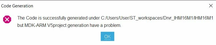

Keil uVision crashes on STM32F303RE project generated by CubeMX
My install of Keil and CubeMX works fine on my STM32F302R8 project. However when I generate a STM32F303RE project in CubeMX the code generator gives message a problem was encountered in generating a MDK-ARM project.
When I load the resulting STM32F303RE project I get a message about an unknown device and then Keil crashes. I don't have the opportunity to look at Project-->options because Keil crashes.

Post the exact error messages you're getting.

The resulting Keil *.uvprojx has missing tags, ie. no <Device> matching a <Device /> as example. I attached the entire uvprojx file, just remove .log extension.
There is more than one item missing. This is the file CubeMx v5.6 generated. It works okay with STM32F302R8 device.

Hello BTrem.1,
Could you please attach your ioc file to check the issue.
