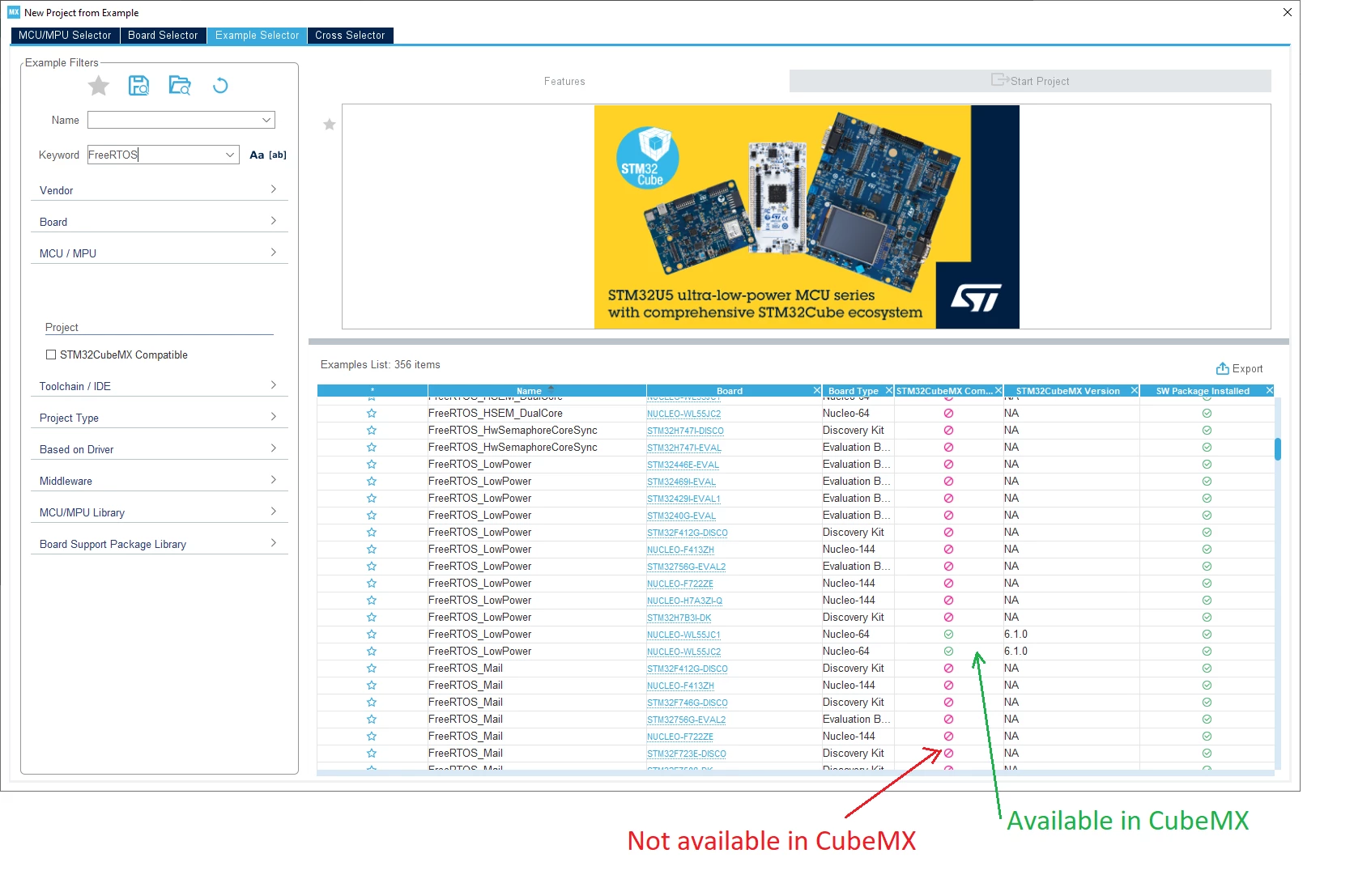

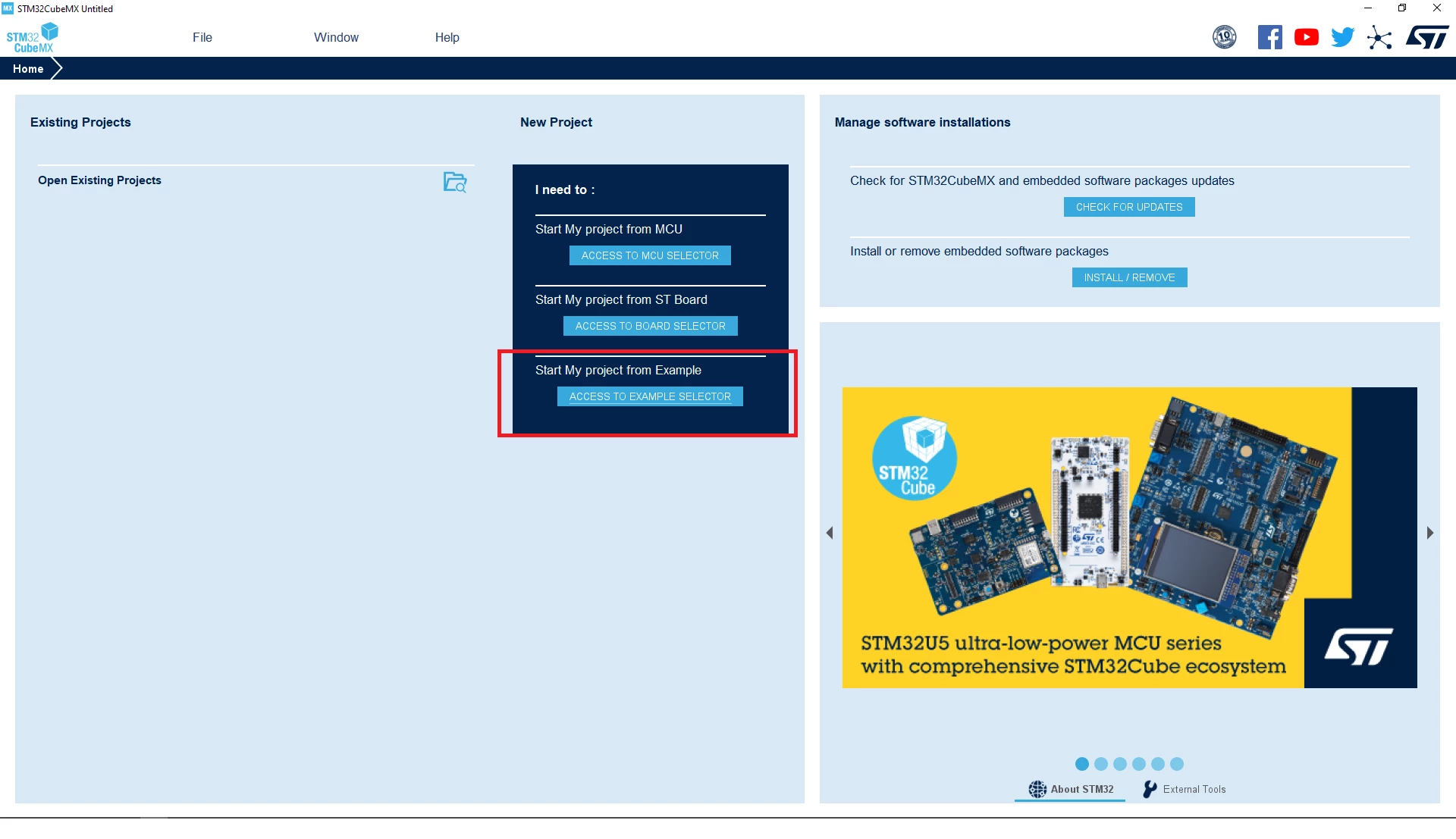

You can find plenty of FreeRTOS Examples under Example Selector in CubeMX, some of which are available for CubeMX (Please refer to the attachment). And as @KnarfB​  mentioned, when you configure your project you can find FreeRTOS under Middleware.
Since you just started using CubeMX, I advise you to watch our tutorial videos, you can access to them easily from Help menu/Tutorial videos in CubeMX.
