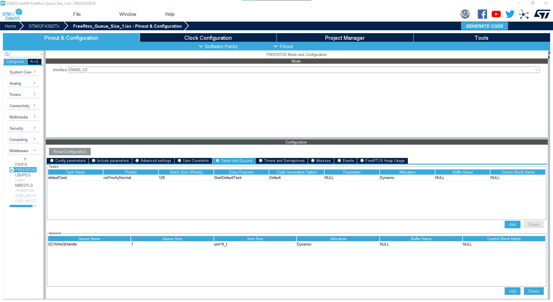

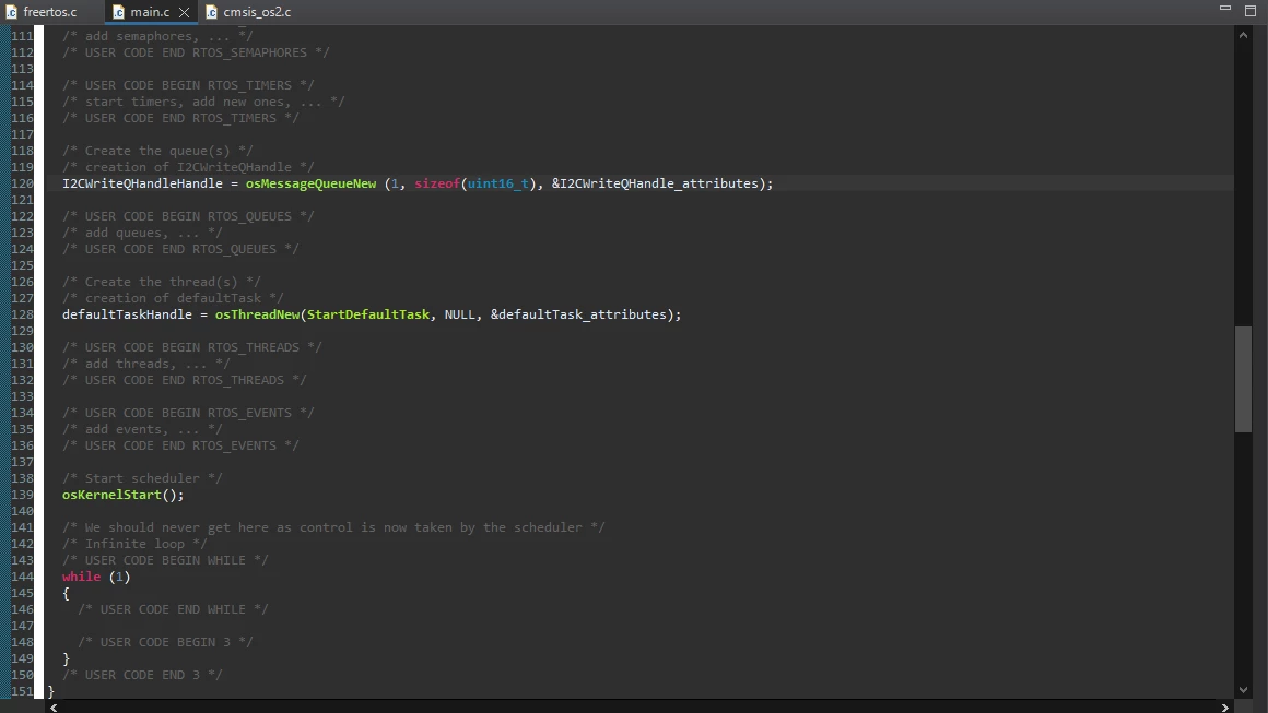

Semer CHERNI
February 23, 2023
Hello @Community member​
Frist let me thank you for posting.
I have an issue reproducing the described behavior.
I am using the following setup:
  • STM32CubeMx 6.7 with the patch applied
  • STM32CubeIDE 1.11.2
  • Windows 10
  • STM32F439 MCU
Down bellow screenshots from the CubeMx setting and the generated code:
0693W00000aHVCLQA4.png0693W00000aHV9XQAW.pngCould you provide a project where the issue is reproduced or at least an *.ioc file.
