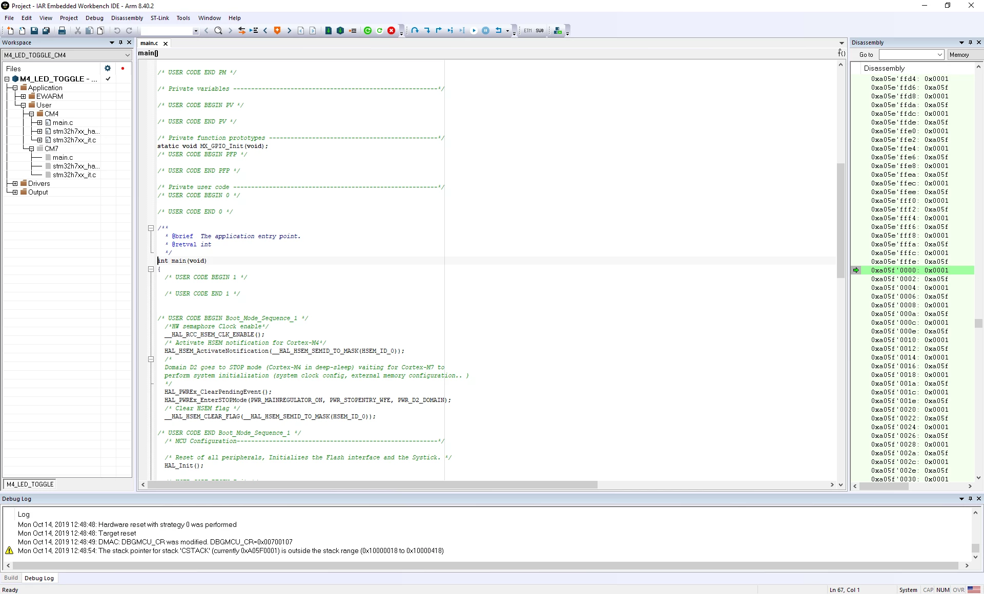

The first issue is, CubeMX does not generates User labels for Pepipherals for example GPIOs assigned to Cortex-M4 similar to User labels assigned to Cortex-M7. Used IAR toolchain.
The second issue is IAR project generated by CubeMX for Cortex-M4, throws The stack pointer for stack 'CSTACK' is outside the stack range. This is broken project generation.

ramkumarkoppu
Oct 14, 2019 12:06 PM UTC
IAR gives me error at M4 debugging time about CSTACK as per the attached screenshot.

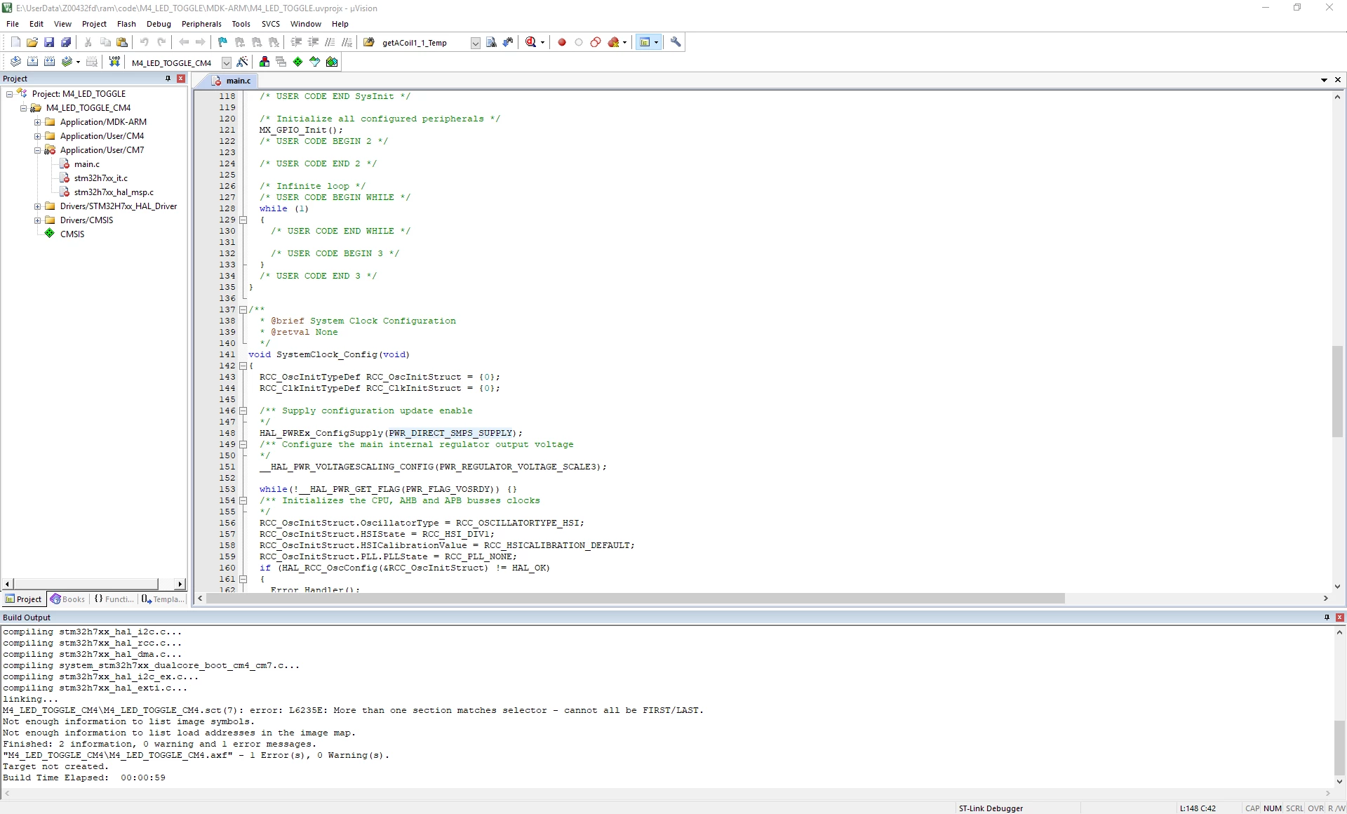

ramkumarkoppu
Oct 14, 2019 12:07 PM UTC
and Keil gives me linker error as per the attached screenshot.

Khouloud ZEMMELI
Oct 14, 2019 12:43 PM UTC
​As I see, it's just a warning and not an issue for IAR, otherwise , for the first request , you're right and issue will be fixed in the next release,

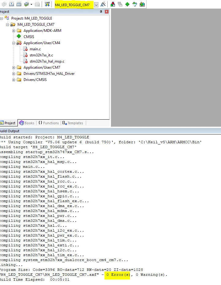

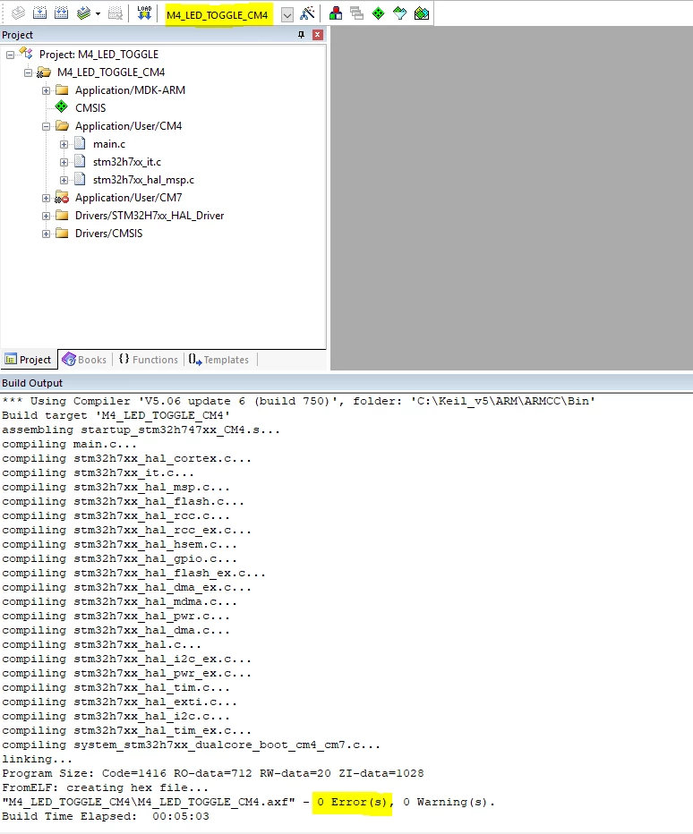

Khouloud ZEMMELI
Oct 14, 2019 1:00 PM UTC
​For keil -M4 , no error reproduced
Khouloud ZEMMELI
Oct 14, 2019 1:02 PM UTC
​Same result for keil-M7
ramkumarkoppu
Oct 14, 2019 1:03 PM UTC
I see error as per the attached screen shot. Using Keil v5.28
Khouloud ZEMMELI
Oct 14, 2019 1:17 PM UTC
​Yes this's an issue in the 5.3.0 CubeMX version ( reproduced ) and it's fixed now for the 5.4.0 version (as attached screenshots).
