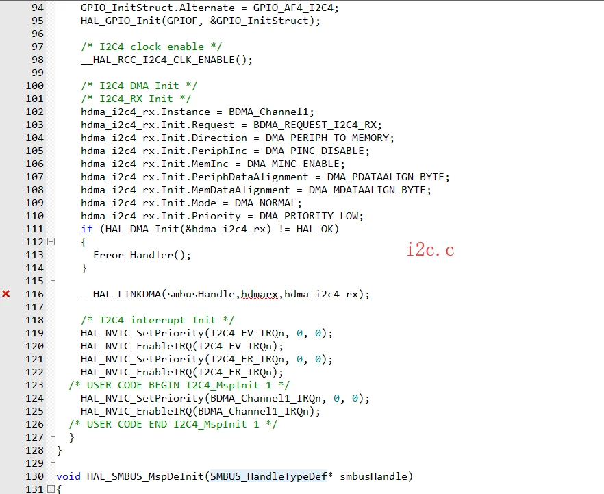

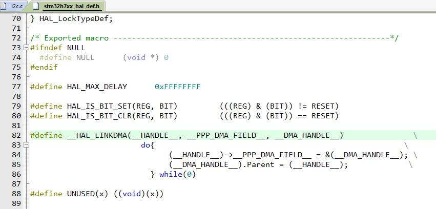

Is this a bug in the HAL library about smbus?

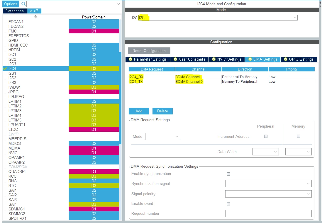

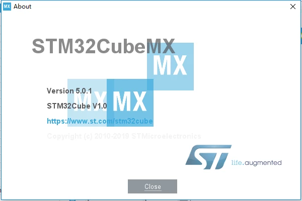

Which CubeMx and Cube package versions used ?
I cannot reproduce this issue. Can you please share your ioc file for check.
Kind Regards,
Imen

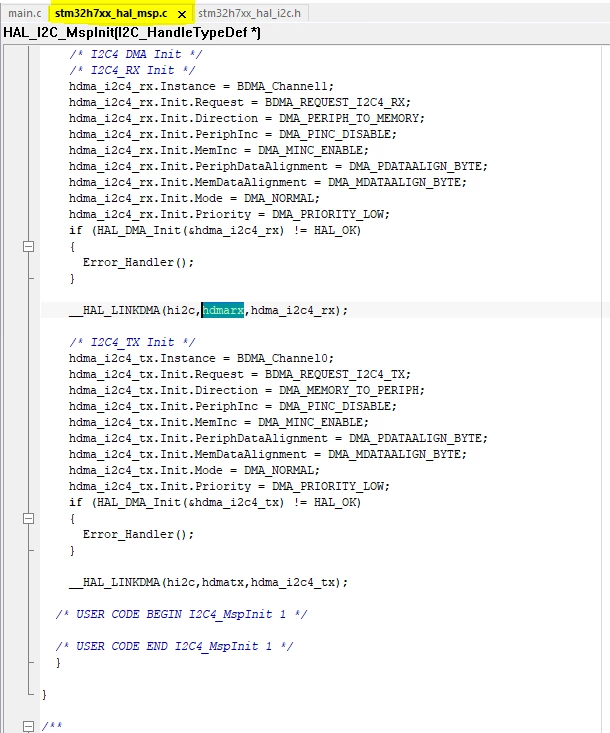

After more check, I confirm that the problem exists for hdmarx and hdmatx with I2C4.
I transfer this issue to developer team for fix.

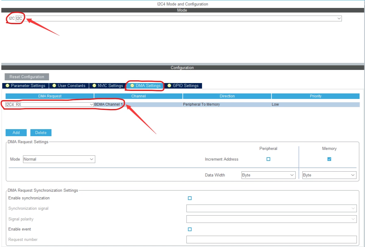

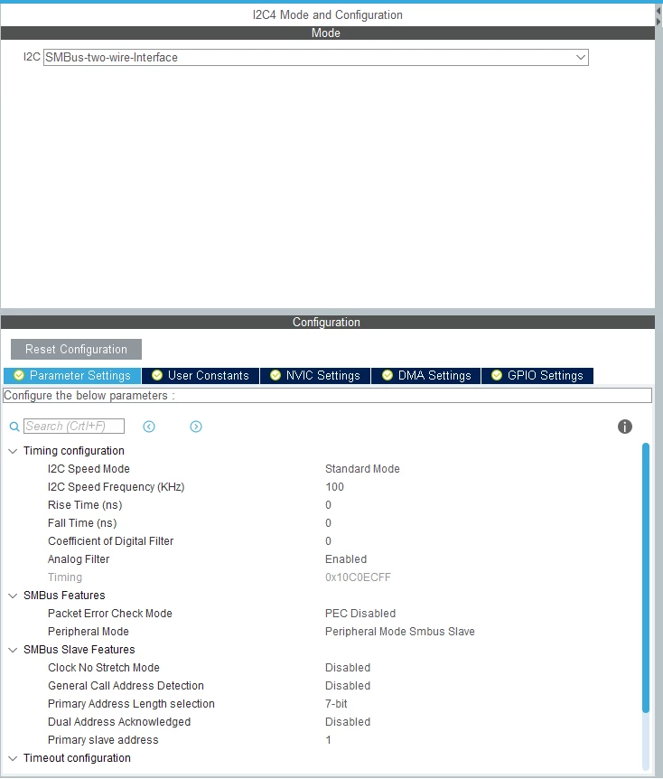

So, the code generated by STM32CUBEMX(5.0.1) in I2C4+BDMA mode is not working now?
Nesrine.JLASSI
Visitor II
February 18, 2019
​Hi @one V​
DMA requests should not be used when I2C mode is set to one of the SMBUS modes.
That will be corrected in the next STM32CubeMX version.
Regards,
Nesrine

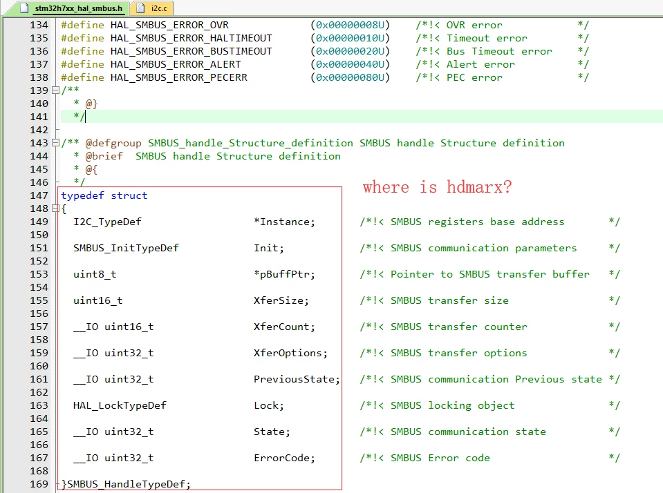

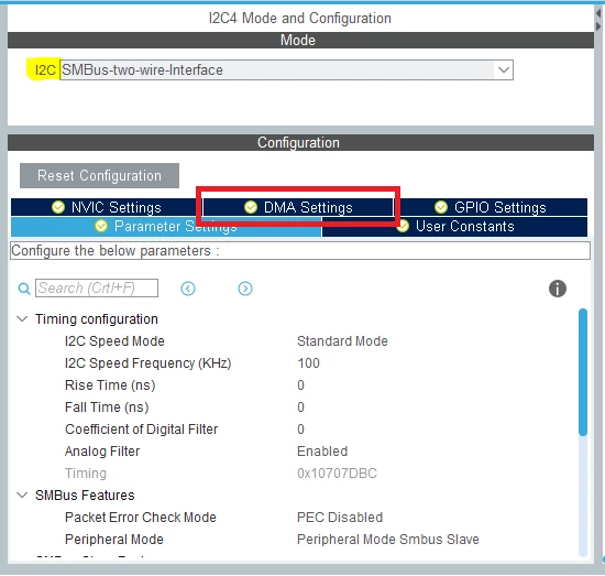

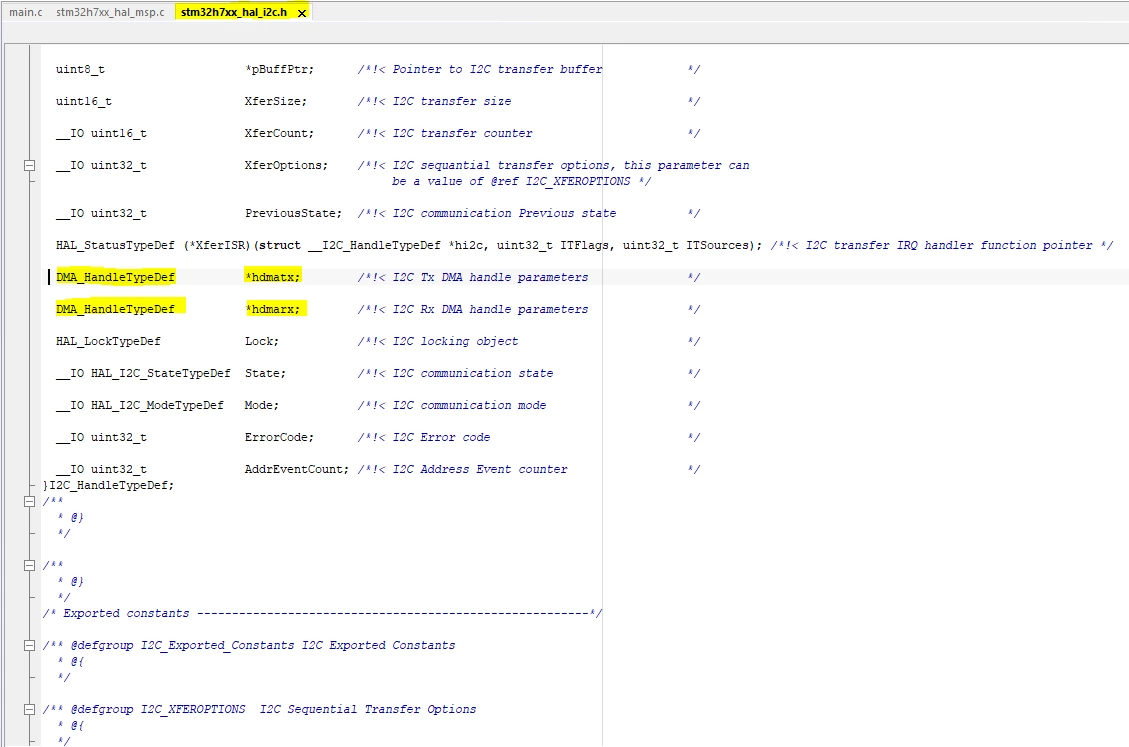

Hi @one V​
In STM32Cube_FW_H7_V1.3.2\Drivers\STM32H7xx_HAL_Driver\Inc path.
In the typedef struct __I2C_HandleTypeDef of stm32h7xx_hal_i2c.h file, you will find :
DMA_HandleTypeDef      *hdmatx;
DMA_HandleTypeDef      *hdmarx;
but it isn't available in stm32h7xx_hal_smbus.h
So, when I2C mode is set to one of the SMBUS modes as shown in this figure:
The DMA Tab must be removed when I2C is set to SMBUS mode .
==> This problem only exists for I2C4.
This bug will be fixed in the next STM32CubeMX version ( STM32CubeMX 5.1: That will be available Week 9 ).
Regards,
Nesrine.

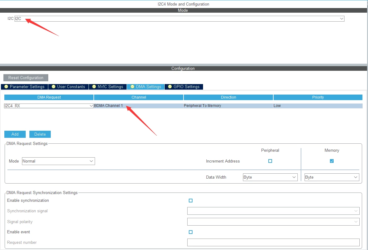

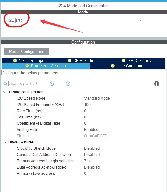

No, no. I already know what you said, and this is why I reported the bug to you. I want to ask is the I2C(i2c+BDMA) mode working properly?
Nesrine.JLASSI
Visitor II
February 19, 2019
​Hi @one V​
No problem when using the I2C (I2C + BDMA) mode as long as there is the definition of hdmatx and hdmarx in the stm32h7xx_hal_i2c.h file.
Regards,
Nesrine.
one V
one VAuthor
February 19, 2019
Yes, the generated code will not report an error, which I also know. But what I mean is, have you actually measured it available?
Thank you again for your answer.
