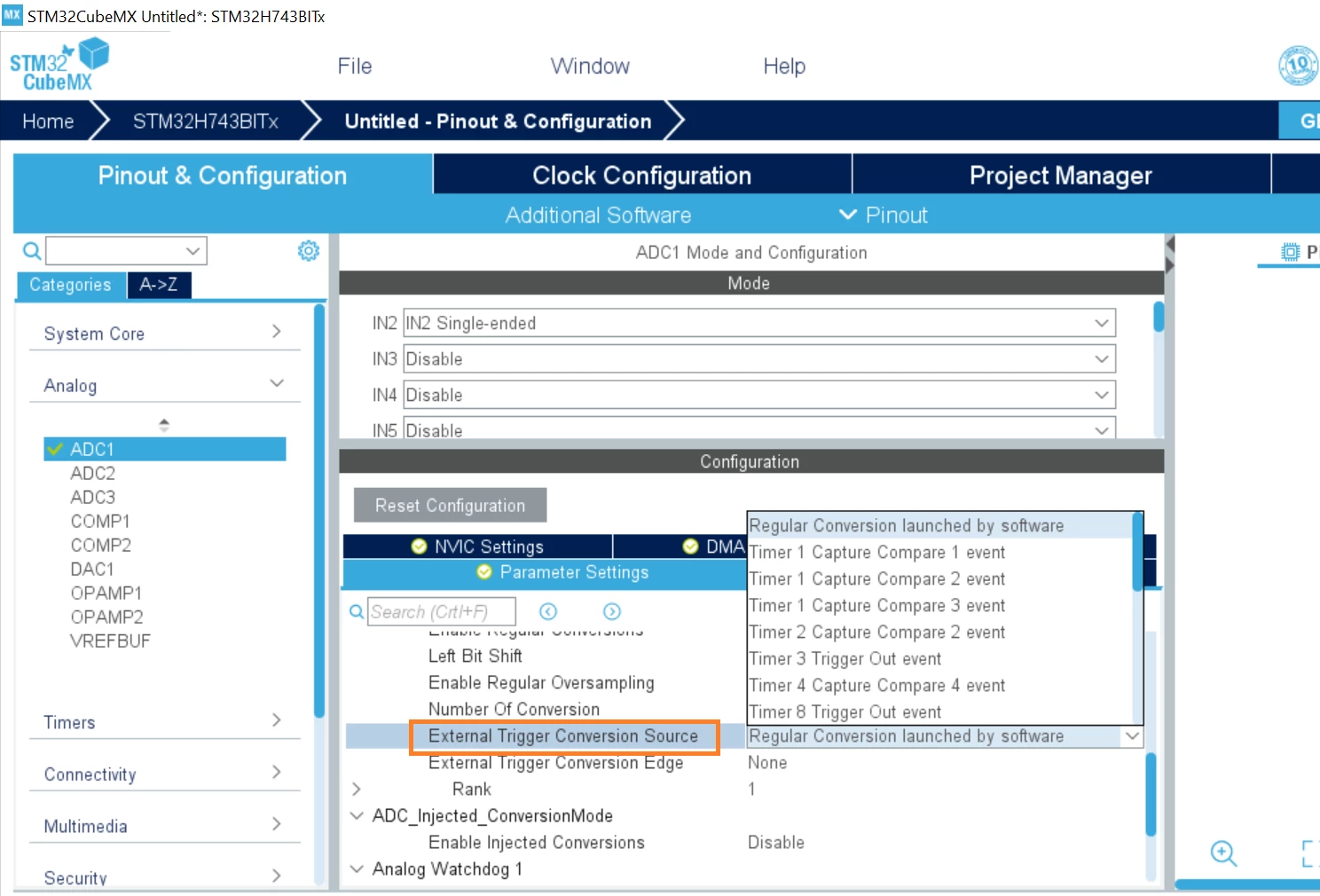

Is there any way to set which source is connected to the timer's external trigger (ETR) in the cube?
 Specifically I'm using the H743BI and am connecting ADC1_AWD1 to timer1's ETR using the hal function HAL_TIMEx_RemapConfig to do this. I should be able to do this in Cube but I cannot discover the setting to do this. Thoughts?

Hello @ETone​
Please see attached picture , from there, you can set the external trigger source :

Thanks for the quick reply! This is connecting the timer to trigger a conversion. I want the adc watchdog to trigger a timer reset.

OK, found the answer. In the Cube, the timer must be set to slave mode RESET and trigger mode set to ETR1 through ADC Remap. Then in parameter settings the heading "ETR remap capabilities for TIM1" will appear. I then was able to select "TIM1_ETR is connected to ADC1_AWD1" from the drop down list.
