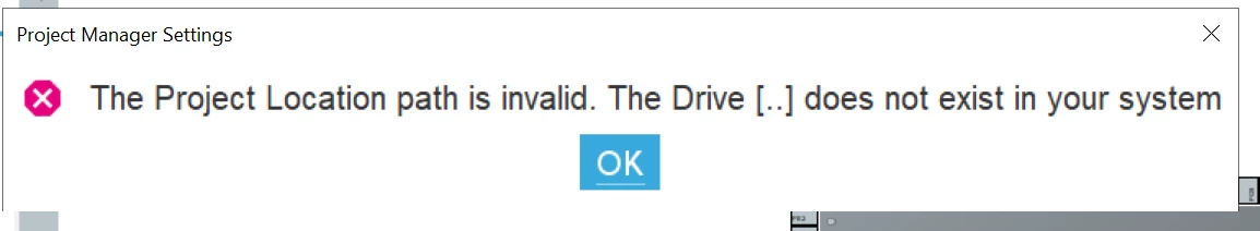

I am trying to configure the project settings via a script file for a command line build of my STM32CubeMX project and I intend to provide the relative path to the parameter- "project path", "generate code" etc. However, it does not accept the relative path and breaks the command line build.
Reference:
https://www.st.com/resource/en/user_manual/um1718-stm32cubemx-for-stm32-configuration-and-initialization-c-code-generation-stmicroelectronics.pdf
(Page-30)
I have attached an example script file that I intend to create. Also, I have attached the error screen that pops up during the command line build

Hello @Jansunil​ ,
Thanks for your feedback,
Which CubeMX version are you using? And where did you place the script file ? is it under STM32_Duplicate Folder?
Could you please provide us with the scenario that led to this issue to help us reproduce it ?
