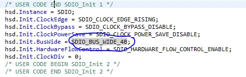

Is there a bug in STM32Cube_FW_F4_V1.27.1 or in STM32CubeMX?
I'm using STM32CubeIDE 1.11.2 and STM32CubeMX Version: 6.7.0.
I have a question regarding the implementation of the SDIO SD card in 4 bit mode on a stm32F407 card
I am using the following configuration
SDIO Global interrupt, SDIO_RX and SDIO_TX DMA
SDIOCLK clock divide factor 5
Unfortunately it doesn't work. The f_mount function returns an error (Error SD card)
On the other hand if I replace SDIO_BUS_WIDE_4B by SDIO_BUS_WIDE_1B
line hsd.Init.BusWide = SDIO_BUS_WIDE_1B; as shown the program works.

Abdelmalek BELLOULA
June 13, 2023

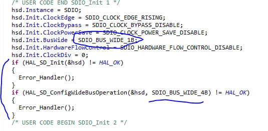

I installed STM32CubeMX version 6.5.0, I generated the code with STM32Cube FW_F4 V1.27.0 I get the following code
_legacyfs_online_stmicro_images_0693W00000dDhI0QAK.pngand it works well and no error in the hardware I checked everything
on the other hand with the latest version of STM32CubeMX 6.8.1, I get the following code: and my program crashes
_legacyfs_online_stmicro_images_0693W00000dDhKaQAK.pngSO ?
Is there a bug in STM32Cube_FW_F4_V1.27.1 or in STM32CubeMX for SDIO?
