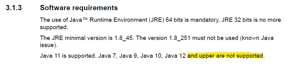

Is it just me or CUBE MX 5.6.1 has a problem with keil and STM32F7 code generation?

I have tried several F7 MCU and the result is the same.

Hi @Grozea.Ion​
Thanks for the feedback, please check your JAVA version.
0693W000004KWZAQA4.pngif the problem is with java version, please try to go back to another JRE version (e.g Java 11 or Java 8)
