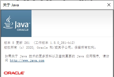

Hi! Aymen,
It distinguishes 32/64 bit automatically and the Java works in Edge. Please see appendix.

This forum only upload one appendix
AXu.11
AXu.11Author
Aug 25, 2020 9:46 AM UTC
One more
AXu.11
AXu.11Author
Aug 25, 2020 9:47 AM UTC
Last one is repeated

Can you please follow theses steps:
1- Remove you current JRE from Windows
2- Download the JRE 64-bit (Offline installer package), through this link
3- Install STM32CubeMX
I'm waiting for your feedback,
Aymen.

Hi! Aymen,
I've installed ST32CubeMX successfully based on your link. This Java works.
Now www.st.com web site also works regularly.
Thanks for your support.
