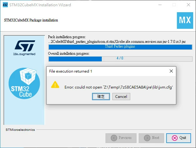

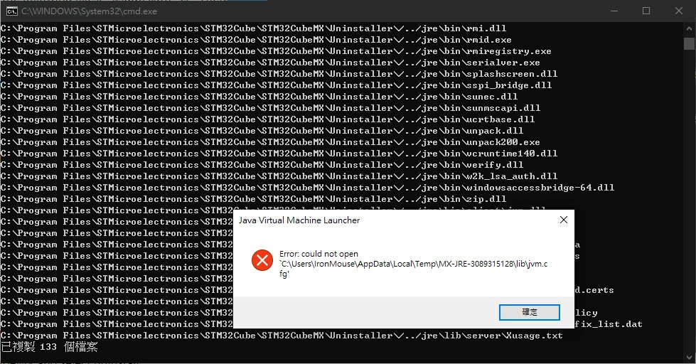

Hi @Khouloud ZEMMELI​ ,
I have same problem.
Error message is from install process 4, and in uninstall.
The folder is existed, just jvm.cfg is missing.
How to fix it?
0693W00000D1ZfrQAF.jpg0693W00000D1Zg6QAF.jpgThanks.

Hi @Ggast​ ,
After some try-and-error, it work for me.
Because some jre files is not extracted from installer.
Try to extract "SetupSTM32CubeMX-6.3.0-Win.exe" manually(ex. WinRAR).
You will get "jre" folder, "Readme.html" and "SetupSTM32CubeMX-6.3.0.exe".
Run "SetupSTM32CubeMX-6.3.0.exe" with administrators rights.
Thanks.
