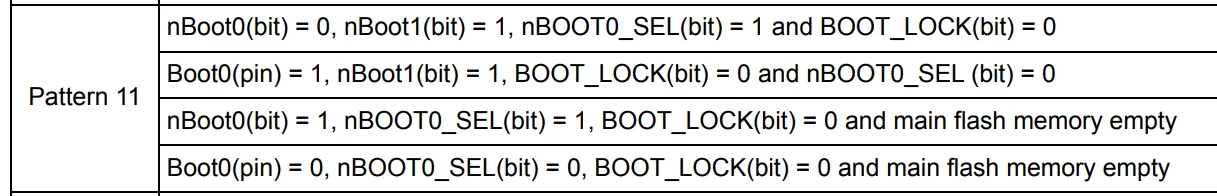

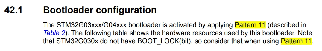

I am using STM32CubeMX and need to set
nBoot0, nBOOT0_SEL, and BOOT_LOCK. (Stm32G031 series is being used and Pattern 11 is being used)

STM32CubeMX cannot modify option bytes as it doesn't connect to the chip at all.
STM32CubeProgrammer is the easiest way to program them. If you're having trouble connecting, I would suggest figuring out why and solving that issue rather than hoping another program will work better.

The STM32G031 DSP seems to have stopped working after performing a firmware update. Is this because the boot settings are not set?
September 30, 2024
No, unless those settings were changed in the firmware update. Which they probably weren't.
