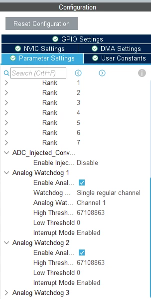

I have two ADC channels that l am trying to configure to have their own ADC watchdog. Experimenting with the threshold values l can get the first watchdog to fire on each channel and it calls HAL_ADC_LevelOutOfWindowCallback() as needed. The second ADC watchdog does not fire at all. I didn't see it be initialized so l created some code that doesn't work. Can someone give insight on this? I eventually plan to use all three ADC watchdogs at once.

Hello @DWill.4​ ,
Which CubeMx release are you using ?
Please share your ioc file for check.
Imen

Hi DWill4,
I am working with same issue, did you solve it ? If yes would be nice to share the solution.
if no;
You should be sure before configuring, there is no ADC conversion on going. Did you try with stop conversion function in the beginning of the second function?
void watchdog_config_ether_arm(void){
/**** you should add stop Conversion****/
ADC_ConversionStop(&hadc3,ADC_REGULAR_INJECTED_GROUP);
ADC_AnalogWDGConfTypeDef AnalogWDGConfig = {0};
AnalogWDGConfig.WatchdogNumber = ADC_ANALOGWATCHDOG_2;
AnalogWDGConfig.WatchdogMode = ADC_ANALOGWATCHDOG_SINGLE_REG;
AnalogWDGConfig.Channel = ADC_CHANNEL_1;
AnalogWDGConfig.ITMode = ENABLE;
/* Configure threshold levels for ARM */
AnalogWDGConfig.HighThreshold = 67108863;
AnalogWDGConfig.LowThreshold = 0;
if (HAL_ADC_AnalogWDGConfig(&hadc3, &AnalogWDGConfig) != HAL_OK)
Error_Handler();
