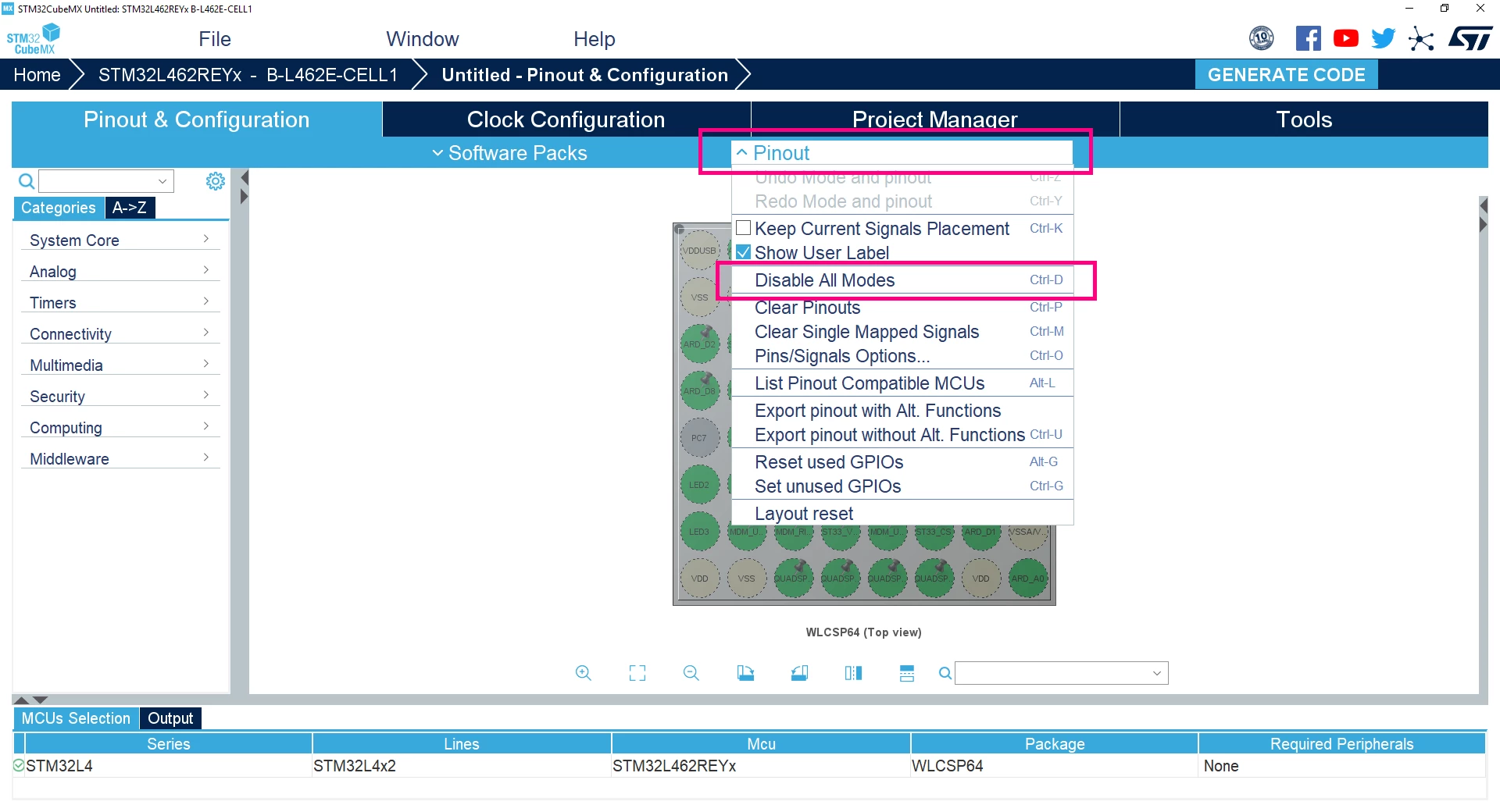

initialize all peripherals with their default mode not working reliably
Is there any way to force the reset to defaults when the dialogue box does not come up asking you?
Using 1.6.1 of the stm32cubeide with L432 nucleo32 development board.
I have seen this once in a while but thought it was fixed in the latest version but a student in my class says it never asks him. So wondered if there is a workaround?

Hi @ASmit.13​ ,
If we start a project from Board we will necessarily have a pop up to ask user if he wants to initialize or not Ip with their default mode.
As mentioned by @TDK probably they are starting the project from MCU.
For your information, If we have a project already configured and you wants to reset modes there is an option in CubeMX from Pinout TAB to do it :
0693W00000Bb7oGQAR.pngHope this helps you.

Jun 10, 2021 5:23 PM UTC
Probably they are starting the project by selecting a chip and not the board.
