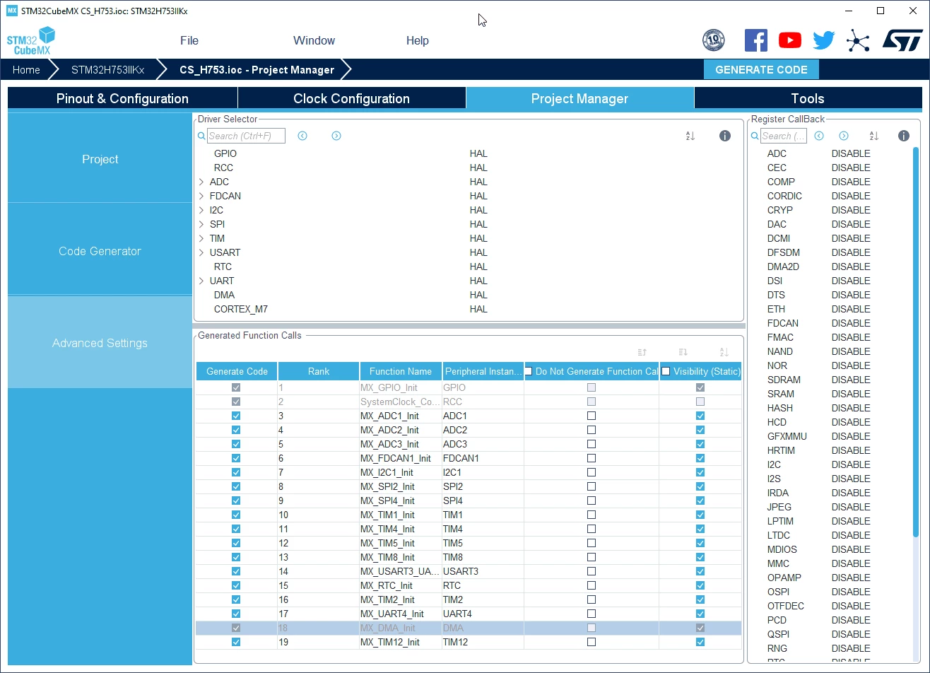

Incorrect order of initialization STM32H753
The ADC and SPI use the DMA, but the CubeIDE initialize the DMA at last ant the SPI initialization fails. See screenshot.
CubeMX Version 6.6.1
Please fix this mistake. Attachment, the Screenshot.
The second problem: I cannot chage the "Rank" order from initialization.
The correct rank will be:
  • first "SystemClock"
  • second "GPIO"
  • third "DMA"
  • then the rest.
Other controllers like STM32G484 is the CubeMX code generation correct.

We have temporary fix this mistake with a user code before MX initializations:
__HAL_RCC_DMA1_CLK_ENABLE();
Regards Markus

This is also inexplicable to me, because I assumed that the problem had already been eliminated. But anyway, there are two ways to fix it:
  • manually inserting __HAL_RCC_DMA1_CLK_ENABLE(); as you have done before
  • moving the position of MX_DMA_Init already in CubeMX by selecting the row and moving it to the correct position with the small, easy-to-miss arrows above the table in the upper right corner
Regards

About your answer:
"moving the position of MX_DMA_Init already in CubeMX by selecting the row and moving it to the correct position"
Please mark me this "easy-to-miss arrows above the table", I cannot find it.
Attachment my CubeMX 6.6.1 View.
Regards Markus

If you create a project for the H753IIK, activate some peripherals first, e.g. ADC1, SPI1, SPI2, TIM1, TIM2, and then after that add a DMA channel for ADC1, for example, DMA is added to the Generated Function Calls at the bottom and cannot be moved.
If the DMA channel is inserted right at the beginning, the function call is also in the right place.

Issue confirmed from my side, it seems that the DMA init order is not set correctly in H7 devices.
Please check the workaround proposed in this thread MX_DMA_Init order in the main.c file generated by STM32CubeMX, How to fix?
I submitted an internal ticket, I will keep you posted.

Hello @Markus Müller​ ,
This issue is fixed in STM32CubeMX latest release.
V6.7.0 is now available under this Link.
