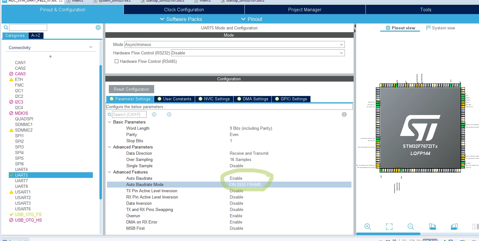

Incorrect code generation for UART5 of F767
I generate code for stm32f767. I use software package 1.16.0 I want to use UART5 in auto baud mode via 0x55 symbol. And USART3 the same. Why code is different?
static void MX_UART5_Init(void){
 /* USER CODE BEGIN UART5_Init 0 */
 /* USER CODE END UART5_Init 0 */
 /* USER CODE BEGIN UART5_Init 1 */
 /* USER CODE END UART5_Init 1 */
 huart5.Instance = UART5;
 huart5.Init.BaudRate = 115200;
 huart5.Init.WordLength = UART_WORDLENGTH_9B;
 huart5.Init.StopBits = UART_STOPBITS_1;
 huart5.Init.Parity = UART_PARITY_EVEN;
 huart5.Init.Mode = UART_MODE_TX_RX;
 huart5.Init.HwFlowCtl = UART_HWCONTROL_NONE;
 huart5.Init.OverSampling = UART_OVERSAMPLING_16;
 huart5.Init.OneBitSampling = UART_ONE_BIT_SAMPLE_DISABLE;
 huart5.AdvancedInit.AdvFeatureInit = UART_ADVFEATURE_NO_INIT;//wtf? ABRMOD0 and ABRMOD1 and ABREN will be 0
 huart5.AdvancedInit.AutoBaudRateMode = UART_ADVFEATURE_AUTOBAUDRATE_ON0X55FRAME;
 if (HAL_UART_Init(&huart5) != HAL_OK){
 Error_Handler();
 /* USER CODE BEGIN UART5_Init 2 */
 /* USER CODE END UART5_Init 2 */
This is ok code for USART3:

Khouloud OTHMAN
Sep 22, 2020 8:58 AM UTC
Hello dungeonlords789,
Thank you for your post . Issue confirmed and raised internally for correction. We will give you an update as soon as possible.

Khouloud OTHMAN
Oct 19, 2020 10:34 AM UTC
Sorry for the inconvenience. The problem has been corrected and the fix will be available in the next release.

Khouloud OTHMAN
Feb 25, 2021 9:22 AM UTC
Hi @dungeonlords789​ ,
Actually this issue has been fixed in the STM32CubeMX version 6.1.0. Did you try with the latest STM32CubeMX version ?
