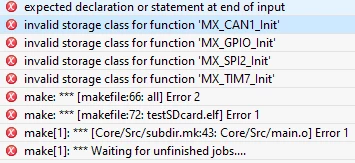

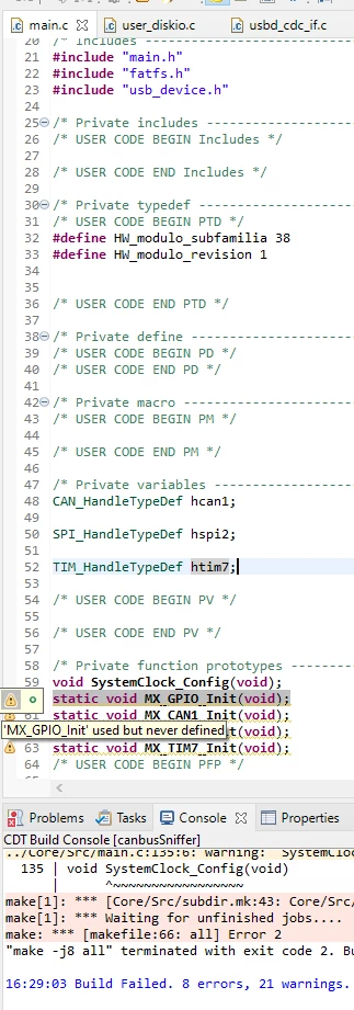

If the compiler says MX_GPIO_Init isn't defined, it's probably not defined. Perhaps you are missing brackets. Hard to tell with the limited information you've provided. If you attach the full main.c file I'm sure the error will be spotted.
Javier1
Javier1Author
Principal
Apr 28, 2022 3:20 PM UTC
@TDK​ You were right, i checked and they are defined but for some reason the compiler throws this error.
Just to clarify, this are all generated by CubeMx i didnt touched them.
The error was not there before i tried to include FatFs (or i tried to include USBCDC in another working FatFs project)
I also checked the "expected declaration..." error, i didnt change anything at all.... i dont think cubeMx missed a ";"0693W00000LzMwcQAF.png

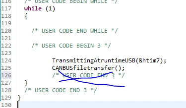

found the issue, thanks for your help @TDK​
I must had copy pasted at some point since the last cubeMx generation the label Inside the while(1) loop by mistake,
/* USER CODE END 3 */
this was confusing cubeMX
0693W00000LzQc7QAF.pngI removed the extra label and everything works
