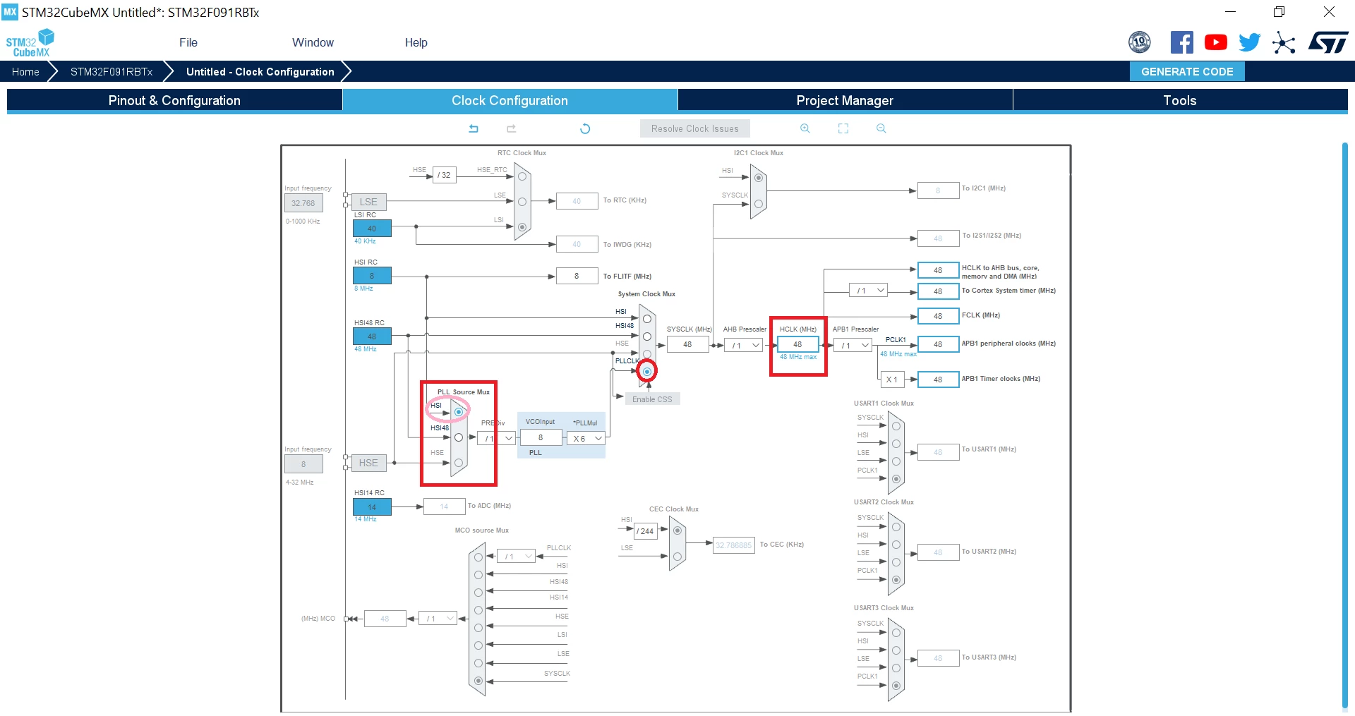

Ons KOOLI
May 27, 2021
Hi @Mgawa.1​ ,
You can use STM32CubeMx software which is freely downloadable from ST official website.
Here is the code generated by CubeMX:

Ons KOOLI
May 28, 2021
Hi @Mgawa.1​ ,
I meant you can use Mx for generating the Clock config only, and replace the generated code by Mx in your project.
This is how I did it:
  • I created a new project with STM32F091RBTx
  • I go to clock configuration tab and configured the clock as you suggested: HCLK = 48 MHz, SYSCLK source is PLL, and PLL source is HSI.
  • Finally I generate the project and copy the generated SystemClock_Config() function into my project.
This is really a simple and clean way to have a "correct" clock config that fits your preferences.
