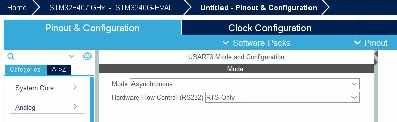

Hello @PMial.2454​ ,
STM3240G-EVAL supports RS232 and not RS485, you have to refer to this UM1461 User manual STM3240G-EVAL evaluation board, for more details.
You will find in the CubeMx configuration, the "Hardware Flow Control (RS232)" option for STM3240G-EVA board as below:

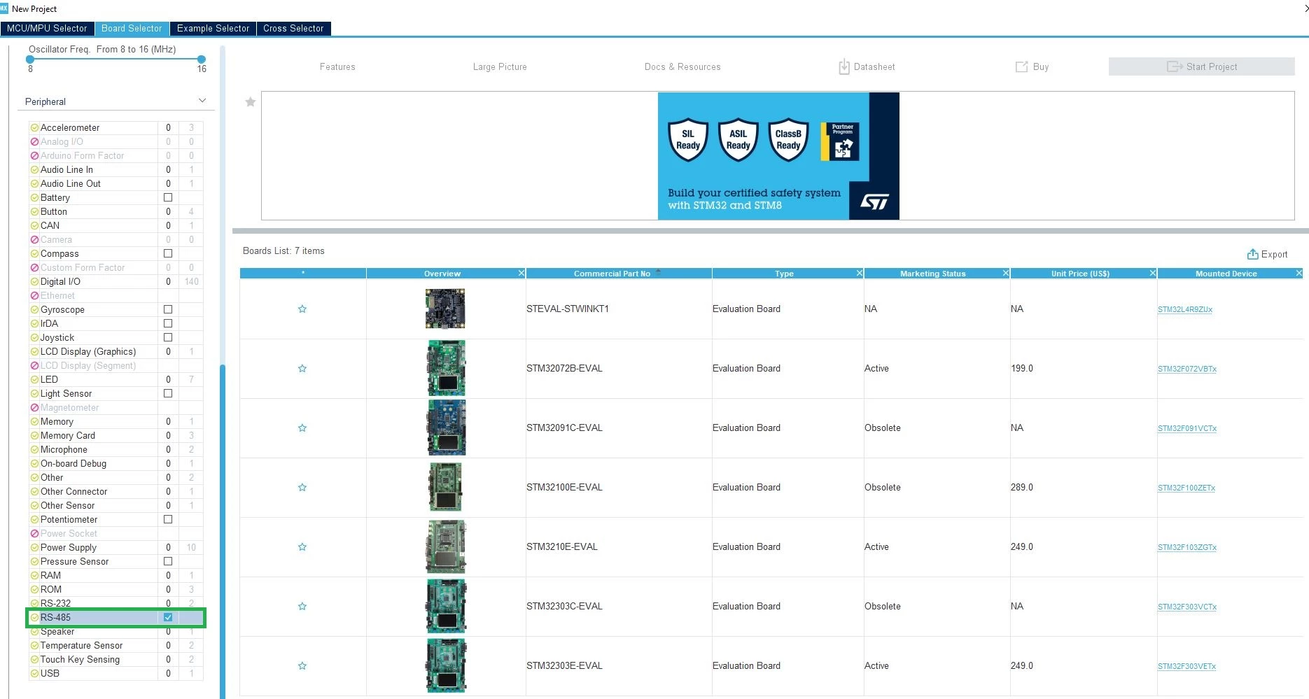

To display the list of ST boards supported RS485:
Launch STM32CubeMX, select File > New Project > Board Selector tab, then filter criteria (RS485) on Peripheral tree.
