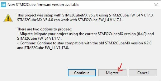

Hello
I'm using STM32cubeIDE with an L431RC
CubeMX invited me to migrate my .ioc from 6.2 to 6.4 and FW_L4 from 1.17 to 1.17.1

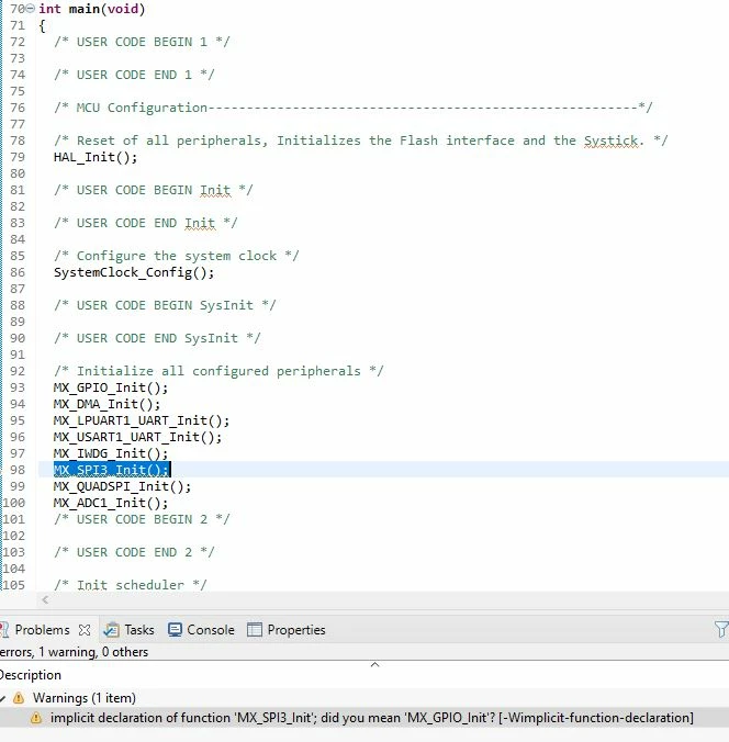

After that I have a warning Implicit declaration of MX_SPI3_Init in main.c
This is only in cubeMX generated code

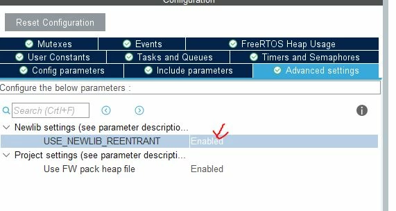

For information cubeMX asked me to enable USE_NEWLIB_REENTRANT in freertos0693W00000JNo2YQAT.jpg
What could I have done wrong?
How to fix this error of cubeMX, which does not include spi.h in main.c?
0693W00000JNo1zQAD.jpg0693W00000JNo1pQAD.jpgThanks in advance
PS : I specify that I have for the moment avoided the problem by adding :
#include "spi.h"
/* USER CODE END Includes */
Here I want to correct the original problem that forces me to do this.

Hello @po221​ ,
Thanks for your feedback,
This is a known issue and it is already raised to the dev team. For more details, please check my answer in this thread https://community.st.com/s/question/0D53W00001K3a7JSAR/missing-include-spih-in-stm32cubemx-v-640-hal-191-stm32h7
Sorry for any inconvenience that this may cause.

Probably a migration or cube generation bug if it persists after generating code. Can you include the IOC?

I could duplicate the issue. Definitely a bug.

I'm not sure I understand what this should change but I just tested and it doesn't change the absence of #include "spi.h" in main.c
