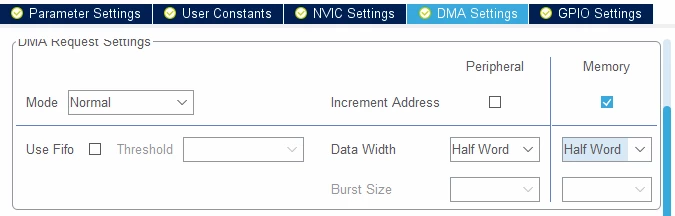

I2S master transfer signal is something wrong
My environment is Nucleo-F446RE with STM32CubeMX 5.1 / TrueSTUDIO 9.3.
I created an I2S master transmit test program. [Full project archive is
here]
  • Transmission Mode / Mode Master Transmit
  • Communication Standard / LSB First(Right Justified)
  • Data and Frame Format / 16 Bits Data on 16 Bits Frame
  • Selected Audio Frequency / 48KHz(*I2S cloks is 61.44(8MHz /5 * 192 /5)MHz)

However, STM32F4 outputs a same signal twice.
For example, in this program, I put the I2S signal as "10101100111100001010110011110000...". But a output signal is "10101100101011001111000011110000..." like this image.
Please tell me how to solve this problem.

  1. In DMA configuration You have peripheral and memory data sizes set to byte, but with 16-bit data both of them should be half-word.
  2. HAL_I2S_Transmit_DMA function's 3rd parameter is data item count (total for both channels) not byte count.

After changing a parameter to "Half Word", that signal was output as I expected. Thank you so much.
