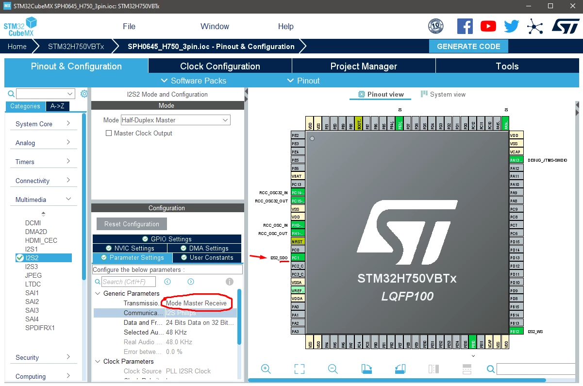

I have connected SPH0645 to STM32H750VBT on I2S2 port. Mode "Half-Duplex Master" Transmission Mode - "Mode Master Recive".
Oscillograms of CLK WS & DATA signals on processor pins correspond to expectations.
HAL_I2S_Receive () function - fills the input buffer with zeros.
In the "Full-Duplex Master" mode, the HAL_I2S_Receive () function fills the input buffer with correct data.
The code was created by STM32Cube MX. Connected in accordance with STM32Cube MX.
Test project here: https://github.com/derkachtf/I2S2-on-STM32H750VBT

waclawek.jan
March 7, 2021
Isn't pin swapping set? Read out the I2S registers and check against the working case.
TDerk.1
TDerk.1Author
March 8, 2021
0693W000008wGX4QAM.pngI re-solder the contact as required by STM32Cube MX.
STM32Cube MX offers pin SDO for Master Receive mode.
But I think he should suggest and configure the SDI pin !
waclawek.jan
March 8, 2021
I don't know what the Cube/HAL functions do, I don't use Cube/HAL. They may cause the pin swap to be activated. Read the SPI/I2S chapter in RM, then read out the SPI/I2S registers for both cases and compare/check/post them.
