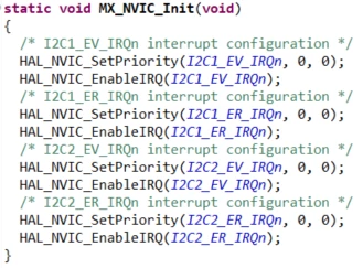

Following some of tutorials, below function is craete automatically.

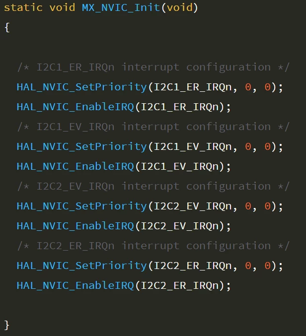

0693W000007AqSKQA0.pngbut when i generated codes, this function was not crated.
this function is wrote by user?

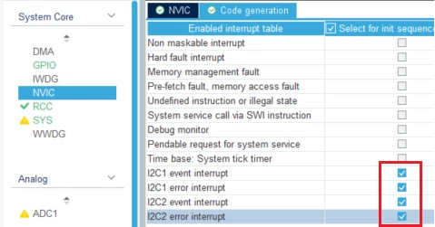

0693W000007AqStQAK.pngIn NVIC tab, that check box have to checked.
