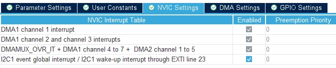

I am trying to run a demo on STM32U083C-DK board.

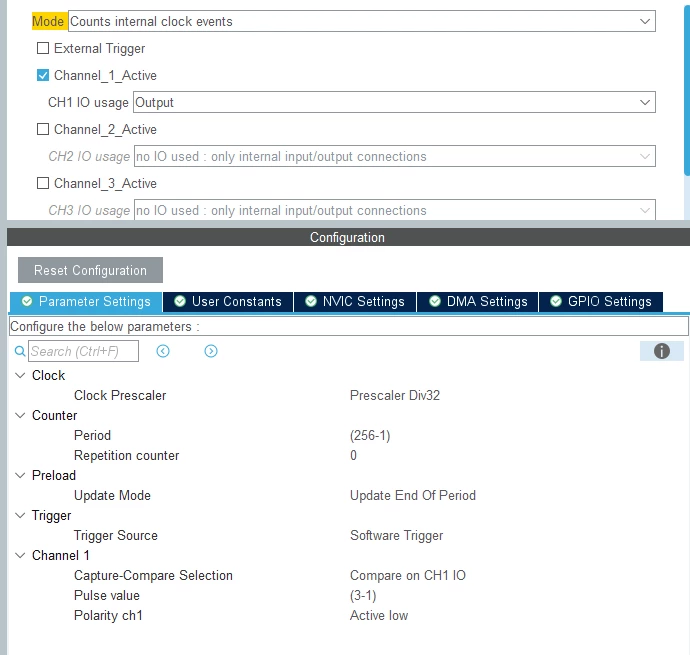

This demo consists of LPTIMER generating PWM that is used for synchronization of I2C read from on-board temperature sensor. Rising edge writes the addres of read and falling edge reads data. The main issue I have encountered is that my synchronization setup works perfectly with UART transmit but with I2C no matter what I try I don't ever get transmit on the I2C bus.
What I checked:
- LPTIMER NVIC is on and is able to start UART synchronization
- I2C DMA works when software triggered. (with synchronization disabled)

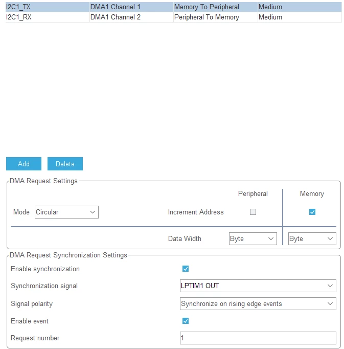

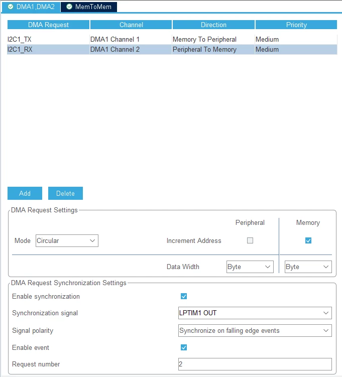

DMA setup for I2C DMA:
LPTIMER config:
Logic analyzer output:
Where D0 is SDA, D1 is SCL and D2 is LPTIMER output

 HAL_LPTIM_PWM_Start_IT(&hlptim1, LPTIM_CHANNEL_1);

 /* I2C1 DMA Init */
 /* I2C1_TX Init */
 hdma_i2c1_tx.Instance = DMA1_Channel1;
 hdma_i2c1_tx.Init.Request = DMA_REQUEST_I2C1_TX;
 hdma_i2c1_tx.Init.Direction = DMA_MEMORY_TO_PERIPH;
 hdma_i2c1_tx.Init.PeriphInc = DMA_PINC_DISABLE;
 hdma_i2c1_tx.Init.MemInc = DMA_MINC_ENABLE;
 hdma_i2c1_tx.Init.PeriphDataAlignment = DMA_PDATAALIGN_BYTE;
 hdma_i2c1_tx.Init.MemDataAlignment = DMA_MDATAALIGN_BYTE;
 hdma_i2c1_tx.Init.Mode = DMA_CIRCULAR;
 hdma_i2c1_tx.Init.Priority = DMA_PRIORITY_MEDIUM;
 if (HAL_DMA_Init(&hdma_i2c1_tx) != HAL_OK)
 Error_Handler();
 pSyncConfig.SyncSignalID = HAL_DMAMUX1_SYNC_LPTIM1_OUT;
 pSyncConfig.SyncPolarity = HAL_DMAMUX_SYNC_RISING;
 pSyncConfig.SyncEnable = ENABLE;
 pSyncConfig.EventEnable = ENABLE;
 pSyncConfig.RequestNumber = 1;
 if (HAL_DMAEx_ConfigMuxSync(&hdma_i2c1_tx, &pSyncConfig) != HAL_OK)
 Error_Handler();
 __HAL_LINKDMA(hi2c,hdmatx,hdma_i2c1_tx);
 /* I2C1_RX Init */
 hdma_i2c1_rx.Instance = DMA1_Channel2;
 hdma_i2c1_rx.Init.Request = DMA_REQUEST_I2C1_RX;
 hdma_i2c1_rx.Init.Direction = DMA_PERIPH_TO_MEMORY;
 hdma_i2c1_rx.Init.PeriphInc = DMA_PINC_DISABLE;
 hdma_i2c1_rx.Init.MemInc = DMA_MINC_ENABLE;
 hdma_i2c1_rx.Init.PeriphDataAlignment = DMA_PDATAALIGN_BYTE;
 hdma_i2c1_rx.Init.MemDataAlignment = DMA_MDATAALIGN_BYTE;
 hdma_i2c1_rx.Init.Mode = DMA_CIRCULAR;
 hdma_i2c1_rx.Init.Priority = DMA_PRIORITY_MEDIUM;
 if (HAL_DMA_Init(&hdma_i2c1_rx) != HAL_OK)
 Error_Handler();
 pSyncConfig.SyncPolarity = HAL_DMAMUX_SYNC_FALLING;
 pSyncConfig.RequestNumber = 2;
 if (HAL_DMAEx_ConfigMuxSync(&hdma_i2c1_rx, &pSyncConfig) != HAL_OK)
 Error_Handler();
 __HAL_LINKDMA(hi2c,hdmarx,hdma_i2c1_rx);

If I am missing something please let me know but I feel like I am either using wrong function to call I2C receive and transmit (which I doubt) or there is a bug.
Thank you in advance for answers.

The example you linked uses UART. You are using I2C which is more complicated in its usage. You will need to initiate each I2C transaction with a call to HAL_I2C_Master_Receive_DMA. Perhaps put this in a timer interrupt callback which is called periodically.
4 replies
Aug 28, 2024 1:13 PM UTC
The basic premise of the program isn't valid. You can't use the HAL DMA routines like this. Look at the code within HAL_I2C_Master_Receive_DMA to see how it starts the transfer. Only after the transfer is started can DMA be used.

Could you please elaborate on your answer? How could I otherwise you the synchronization of I2C?
I am basically trying the same thing as in: https://github.com/STMicroelectronics/STM32CubeH7/tree/master/Projects/STM32H743I-EVAL/Examples/DMA/DMAMUX_SYNC
TDKBest answer
Aug 28, 2024 1:44 PM UTC
dryet
dryetAuthor
Aug 28, 2024 1:54 PM UTC
Okay, thank you.
In my excercise I wanted to make I2C read to my memory completely automatic in the backround using DMA so it updates temperature values automatically without any MCU work and I can get the latest value in my code.
I will continue to work on my example and I will try to come up with a way to make it work
