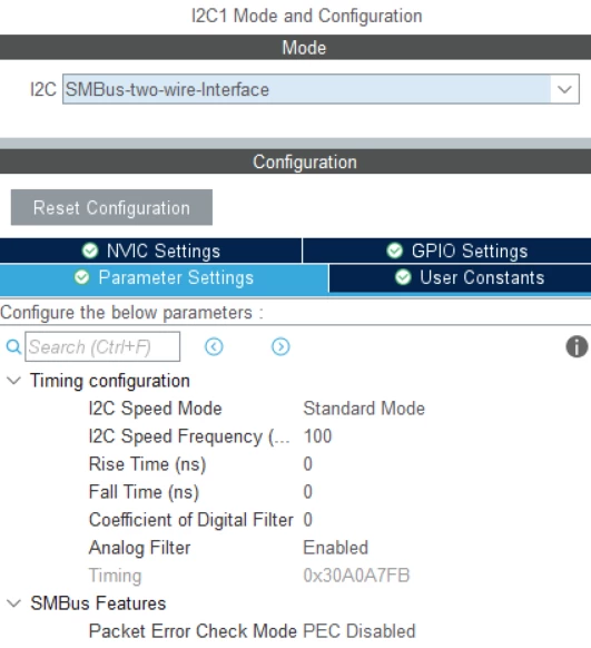

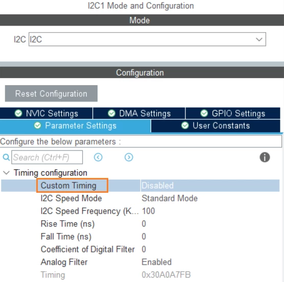

I2C Custom Timing not available in SMBus mode (CubeMX)
Why CubeMX I2C Custom Timing MCU connectivity config option is unavailable in SMBus mode? Custom Timing is an advanced option for those which really know what they are doing and I do not think it makes sense to take it away in SMBus mode.
On the opposite side, it would make a lot sense to set initial Rise Time and Fall Time to more proper values (e.g. max allowed 1000 and 300ns) to simplify setup for novice users. Current default zero values are always incorrect.
In addition, Cube MX is unable to set up timings for standard mode 10kHz. Such mode is supported - see RM0440, 41.4.10 I2C_TIMINGR register configuration examples, p.1888-1889
Tested with the latest CubeMX 6.7 and STM32G431KBTx.

I am well aware of SMBus standard being more strict than I2C although: 1) the same timings can be achieved in more than one way, e.g. depending on PRESC registry value. 2) Custom Timings are for those who really know what they are doing and, I believe, there is no need for CubeMX to protect such engineers from making mistakes. 3) I believe that CubeMX does not always calculate correct settings, which I explained in a different post some time ago, that includes SMBus mode. For that reason, I always prefer calculating timings and registry settings myself, including SMBus. That is the reality.
I appreciate your time, but I think it would be better to focus on the issue in hand, that is, CubeMX preventing the settings I want, rather than restating irrelevant I2C basics.
Regarding the default rise/fall times; again, I am afraid that you missed my point entirely. My intention was to suggest CubeMX improvement, not to ask for I2C specs.

Hello @Ghofrane GSOURI​, there is another issue with CubeMX SMBus support. Setting "Coefficient of Digital Filter" to a non-zero value adjusts timings, but it does not seem to actually enable the digital filter. Digital filter is enabled by calling HAL_SMBUS_ConfigDigitalFilter() and call to this function is missing from generated MX_I2C1_SMBUS_Init() function. I think this is a bug - probably never reported since no one relies on HAL to use SMBus anyway.
