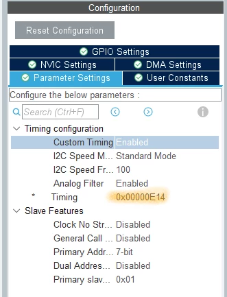

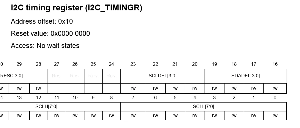

Can anyone point me in the direction of some more information about the custom timing under the I2C parameter settings?
Are we modifying a specific register? or something else? Do each of the 8 bits do something different?

just read in rm , I2C -> registers : (here the magic timing value is written :) )
You cannot generate a "new" I2C bus timing , its just about : how long are hi and lo periods (relative, at its fixed clock , 100 - 400kHz ) and when the level decision on receiving is made.

HI AScha.3,
I have read the RM and it's less than helpful, it talks about CubeMX being able to set the "magic" number but doesn't give any hint on what that should be. Unfortunately, none of the "standard" settings are able to coax an ack from our ADG715 analogue switches over I2C. The project is substituting a PIC18F with the STM32 in an existing product that is on the market, it's been a nice learning project as everything else is defined and works so it has "just" been figuring out how to make the STM32 either mimic the PIC18F or rewrite the functions to make use of the STM32 abilities. It appears that in our application our ADG715's require some decidedly non-standard timings (being able to compare the traces with the working PIC18F showed the STM32's pulses to be very "pointy", relatively long ramp times and short plateaus vs. the very square and slower PIC18F. I would have long since given up if it wasn't working with the PIC18F!
I finally managed to get an ack last night after trying some random numbers in the custom timing which resulted in a much squarer waveform, so getting it to work is possible I just need a method for relating the registers to the "magic" number that can be set in the IOC / CubeMX

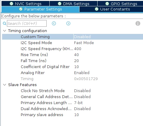

 the "magic" number is just the I2C timing register - as i showed in previous post.
And i cannot believe, its so big problem to use the ADG715 with I2C here.

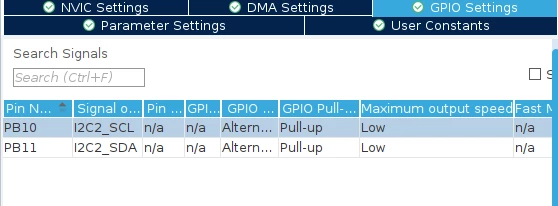

Just : what are your pullups on i2c lines ?
For hi-speed i recommend : try 2k7  and 400kHz setting, i show you how i set it:
Try this setting with your chips, 2k7 pullups ; i have 38MHz as clock for i2c , fyi.
