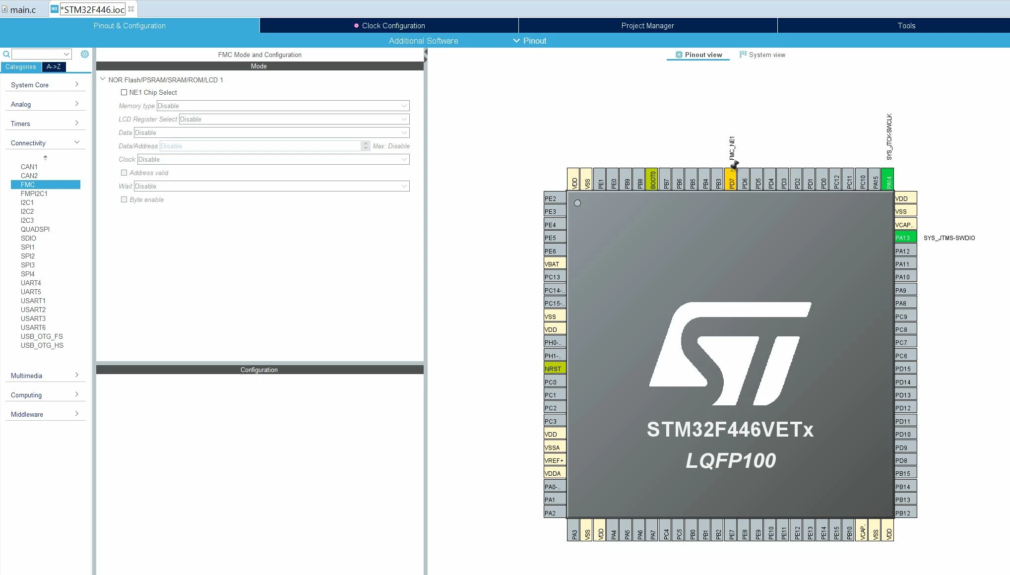

I would like to know if STM32F446VCT7 supports FMC NAND or not.
As far as I read datasheet it says there is a support for that, but in STM32CubeIDE under FMC I cannot select NAND. There is simply no option for that. See attached file.

Fixed in rev.8 of 'F446 DS.

Click NE1 Chis select and you can continue

Actually if I check the NE1 there is no NAND option. Only NOR, RAM or LCD....
So, no I cannot continue...

It appears that there is only one NAND chipselect, NCE3, and that is not present on the 100-pin package. The footnote to Tab.2 in DS10693 Rev 7, mentioning NCE2, is probably copy-paste from the 'F40x datasheet.
@Imen DAHMEN​ , can you please have a look at this issue? Does the 'F446 have FMC_NCE2 or not?

I raised this internally for check and will come back to you with update.
