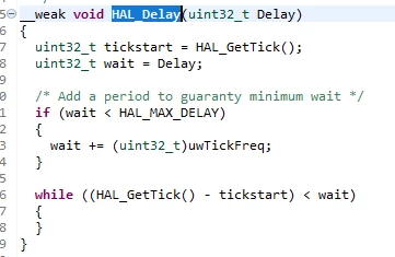

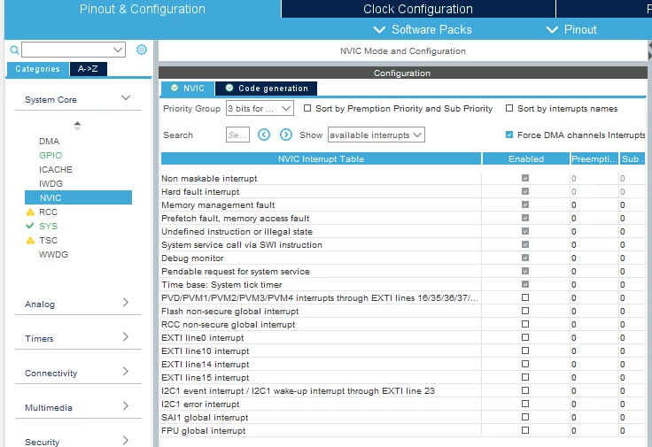

I would like to know how can I make the HAL_Delay function work. I configure the System CLock with CubeMX, when I compile the prog there is no errors but my program loops in the HAL_Delay function.
How to test only the HAL_Delay (...).

gbm
Jan 5, 2023 3:16 PM UTC
Check the operation of SysTick_Handler() using the debugger. Make sure it fires correctly. If not - check what you did wrong (disabled all interrupts, misconfigured SysTick).

Karl Yamashita
Principal
Jan 6, 2023 5:22 AM UTC
Well if I had to guess, you're probably calling HAL_Delay from an interrupt, which will not work.

DYann.1
DYann.1Author
Senior II
Jan 6, 2023 9:29 AM UTC

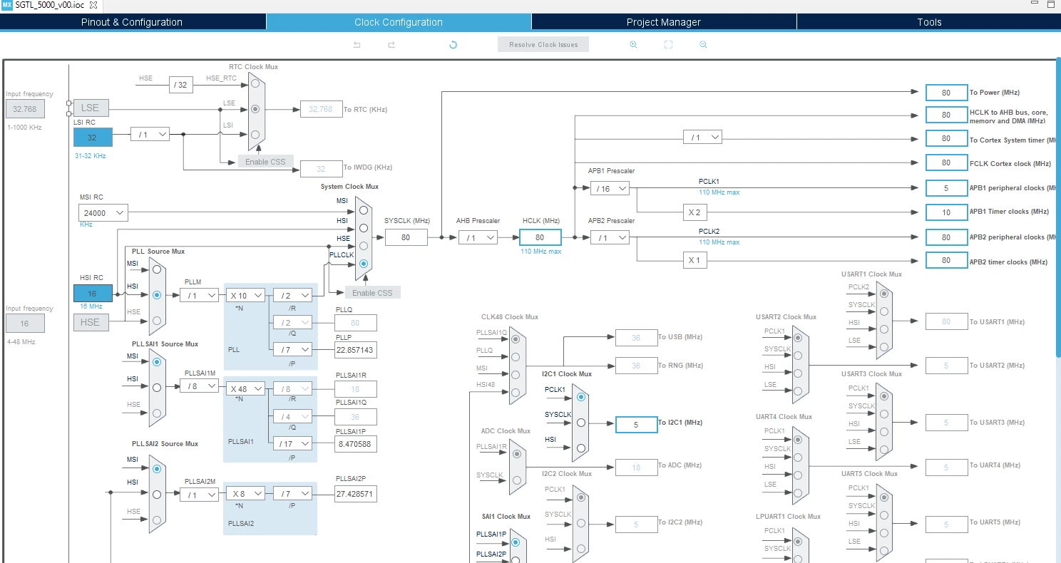

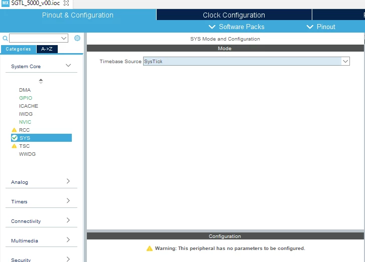

I don't know if I use with interrupt this function HAL_Delay but It's the summary of my configuration
0693W00000Y7YzIQAV.pngOn the other hand, I can see the SysTick of my configuration is not configured
0693W00000Y7Z01QAF.pngyet my Clock is configured, I probably missed a step. Do you know if I can find information how to activate SysTick ?
0693W00000Y7Z0aQAF.pngI think when you configure when you configure the Clock the SysTic is automatically configured.

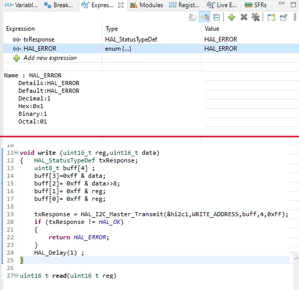

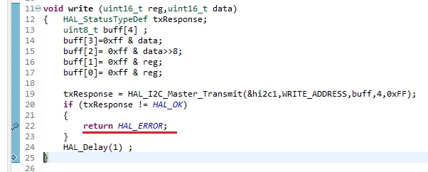

After some changes, now I think my I2C does not work correctly. In this prototype :
0693W00000Y7aFqQAJ.pngThe HAL_I2C_Master_Transmit return an error, probably for the same reasons. Do you know where I can find examples with I2C ?

Karl Yamashita
Principal
Jan 6, 2023 1:39 PM UTC
It could mean that the I2C slave address is invalid or a physical connection issue. You should see what the txResponse value is. Is that where the HAL_Delay is stuck? And why is a 1ms delay needed in that write function?
Also, your write function is a void and you are trying to return HAL_ERROR. The compiler should have gave you a warning about that..
You can find examples in your repository
C:\Users\<user name>\STM32Cube\Repository

DYann.1
DYann.1Author
Senior II
Jan 6, 2023 1:48 PM UTC
Thank you, yes I have a number of error is 1, but what does that mean ? I don't know.
0693W00000Y7aXfQAJ.pngYes I have a warning but I don't know how to return a value. For the hardware (wiring and component address, all is correct). I think it comes from the Clock or SysTick. In fact the I2C need theses parameters.

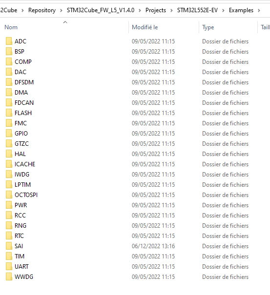

DYann.1
DYann.1Author
Senior II
Jan 6, 2023 3:14 PM UTC

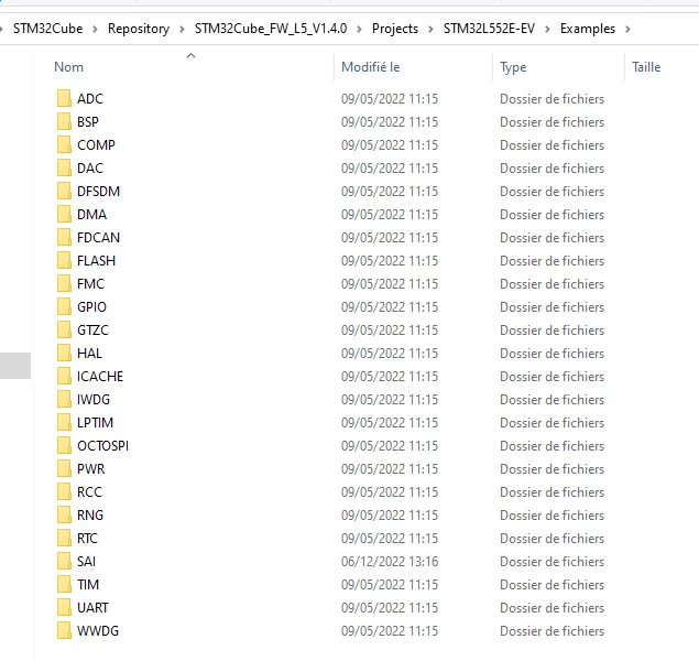

After browsing the directory I couldn't find the I2C example with my evaluation board.
0693W00000Y7b7TQAR.pngProbably I have to look elsewhere.
Karl Yamashita
Principal
Jan 6, 2023 5:32 PM UTC

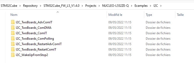

You can use the Nucleo example. It is the same Microcontroller.
C:\Users\<suer name>\STM32Cube\Repository\STM32Cube_FW_L5_V1.5.0\Projects\NUCLEO-L552ZE-Q\Examples\I2C
Also, i'm not sure what I2C device you're trying to write to but if it's a 16 bit register then you're not writing the value to your buff array correctly.

DYann.1
DYann.1Author
Senior II
Jan 9, 2023 7:48 AM UTC
I can see sevaral example but I don't know which file corresponds to my evaluation card ?
0693W00000Y7gRsQAJ.pngProbably I2C_TwoBoards_ComPolling may suit my needs ?

Pavel A.
Jan 9, 2023 9:21 AM UTC
So is your board the Nucleo L552ZE-Q?
DYann.1
DYann.1Author
Senior II
Jan 9, 2023 9:24 AM UTC
Hi Parvel,
No my board is 'STM32L552E-EV' but there is no example with this evaluation Board.

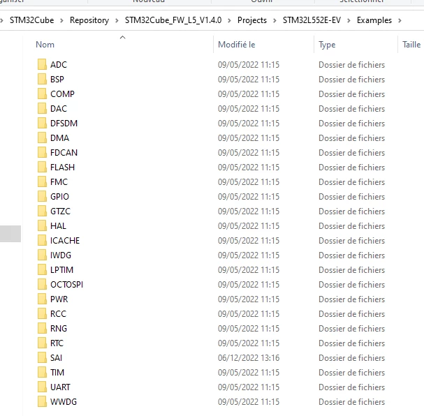

Jan 9, 2023 12:27 PM UTC
No my board is 'STM32L552E-EV' but I don't have a example I2C with this board :
