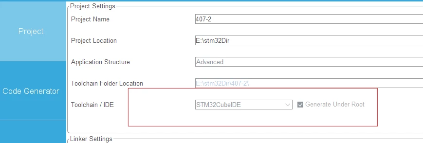

I was trying using cubeide to generate code. But in toolchain/ide, I can not choose another ide. Could someone tell me the reason for this. I am using 1.9 CudeIde

If you want to generate for other IDE, use the standalone CubeMX.
