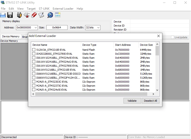

I want use external loader in STM32F767 with W25Q256, but have no idea,anyone can help me or give me some advice.

If i want to use external loader and not in basic list,how can i  write a custom external loader?
I only use cubeIDE and cubeMX,can I write the file(*.stldr)?
I find the W25Q256.flm but can't use it.

I use QSPI example can test this ,but I want do some image to external flash like this,my spi flash is W25Q256 is not in this list, how can I create it?

There are example sources/projects in [STM32 ST-LINK Utility]\ST-LINK Utility\ExternalLoader\, you can start by reading what's in these. Some of them are Cube-based, although not CubeMX. There's some rudimentary documentation in UM0892 (ST-LINK Utility UM.pdf) chapter 5. Note, that the functions are intended to be run from RAM, so it's important to observe the attached linker files. Also, they can't use interrupts, which makes things even a bit more challenging.
As an alternative to using STLinkUtility (or the Cube Programmer), you may be better off writing a simple application for your board, enabling to transfer data to be programmed e.g. through USART, using some simple protocol e.g. XMODEM.
