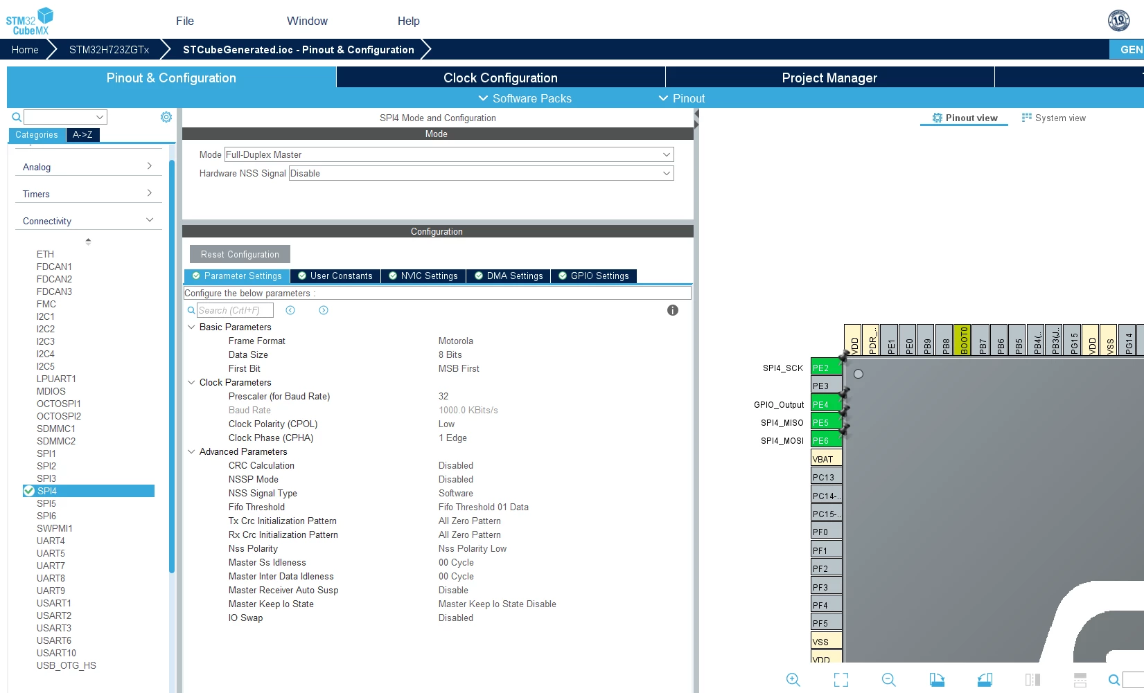

I want to read / write NORFLASH that is externally connected to H723.
H723ZGT6 Nucleo-144
CubeMX 6.3.0
[ data sheet ]
   H723: DS13313 Rev2
[NOR Flash]
   S25FL256L
[Reference manual]
   H723: RM0488 Rev2
   S25FL256L: 002-00124 Rev. * H
I am currently using H723 to create a project to read and write NORFLASH.
However, the read / write is not successful.
I want to read and write with H723 as the master and external flash as the slave.
1. Is the CubeMX setting incorrect?
2. Is there a problem with the idea of SPI communication?
I searched, but couldn't find much reference sample code that could be used to read and write the external flash.
Please let me know if there is any sample code or site that you can refer to.

Hi @june​ ,
Thanks for your feedback,
Seems that your SPI configuration in CubeMX is correct. I believe that your issue comes from the part of the SPI communication in your code, I am adding our colleague to the loop to check with us this issue.
@Imen DAHMEN​  could you please review this issue and help @june​ resolving it.

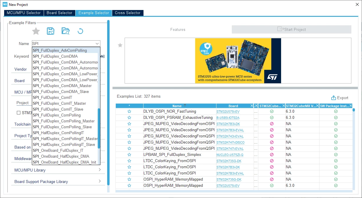

Also, you can refer to the example selector in CubeMX, there are several SPI examples there that might help you (Please see the attachment).0693W00000Hog5LQAR.png

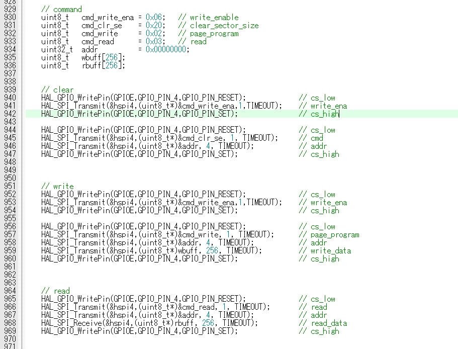

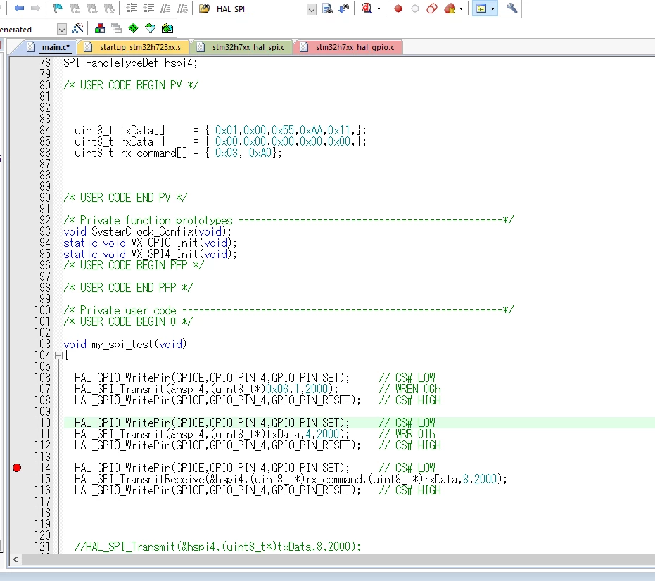

Dec 15, 2021 2:10 PM UTC
GPIO_PIN_SET is a high level while GPIO_PIN_RESET is a low level. You have them backwards.
Edit: Unless NORFLASH is backwards for this line? I guess it's possible. But in that case, the comments don't match the code.
june
juneAuthor
Jan 5, 2022 9:32 AM UTC
Thank you for your advice.
I made a mistake.
The comment was correct and the code was incorrect.

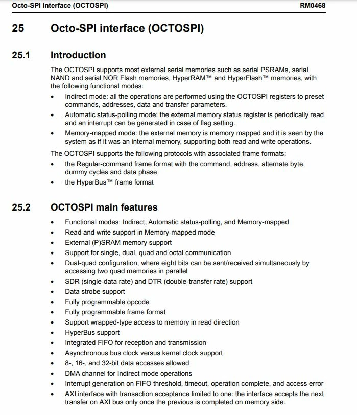

Hello @june​ ,
I advise you to use OctoSPI to read and write the external flash.
For that, you can refer to the OSPI_NOR_ReadWrite_DMA example within STM32CubeH7 MCU package.
Please have a look at these resources in order to get more details about OctoSPI features and usage:
  • AN5050 Application note Octo-SPI interface on STM32 microcontrollers, which explains how to use and configure the OCTOSPI interface in order to write and read external flash, and provides some practical examples.
  • OctoSPI-STM32H7 presentation
  • RM0468
0693W00000HoiN8QAJ.jpgHope my answer helped you!
