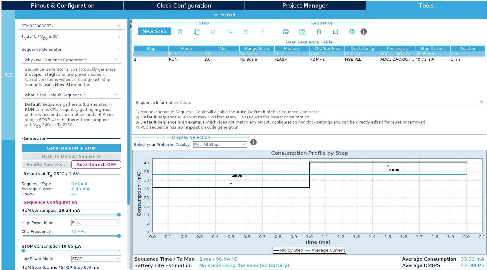

I need the consumed current value of Microcontroller part STM32F303ZET6. I am confused after checking datasheet. Please help.

It's a complex multi-variable ​problem depending on what you're doing, the clock speeds, and a lot about what the pins are connected too and driving.
S​ome of the CubeMX tools can estimate what specific peripheral combinations contribute.

right, see in "Tools" in Cube...F303 -> at 48M + 72MHz

I can see 40.71mA consumed at 72MHz.
Can I consider 40.71mA as the maximum current consumed by the IC?

those are estimates as @Community member​ said,
Depends of which peripherals youre using, i always design for 150mA minimum. for my stm32F072 and stm32F105

I am using 1 SPI, 2 UART & 1 I2C.
SCLK - 307KHz.
How much current to consider for STM32F303ZET6?

If i consider IDD, then its 15.3mA( 8MHZ, Flash exe & All peripherals enabled)
If i consider IVDD, then its 160mA.
Which one to consider IVDD or IDD value?
@AScha.3​ @Javier Muñoz​
Please help here.

you just said your clock was 72Mhz, so the estimates are 77,4mA
this is destruction limit of loading the chip, ie driving many LEDs direct from pins
this is max mA , what chip needs at 8M .
or 40.71mA consumed at 72MHz .
