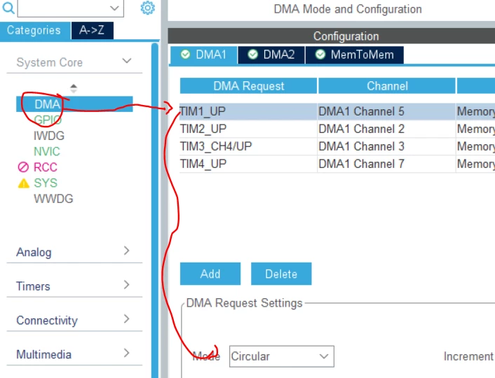

I'm working on stm32 U5 on an UART with DMA. It's good if the DMA is in normal mode, but when I want to activate the circular mode on RX dma size, my CPU enters in hard fault .
i see in stm32u5xx_hal_dma.c that only normal mode ofr dma is compliant. How can I manage the ciricular mode ?

Show us the code, speciall atention to the function initialising the DMA where you pass the RXbuffer

 HAL_StatusTypeDef ResultHal = HAL_OK;
 pDMAHandle->Instance    = pDMAChannel;
 pDMAHandle->Init.Request  = DMARequest;
 pDMAHandle->Init.Direction = DMADirection;
 if (pDMAHandle->Init.Direction == DMA_PERIPH_TO_MEMORY)
  pDMAHandle->Init.SrcInc = DMA_SINC_FIXED;
  pDMAHandle->Init.DestInc = DMA_DINC_INCREMENTED;
 else
  pDMAHandle->Init.SrcInc = DMA_SINC_INCREMENTED;
  pDMAHandle->Init.DestInc = DMA_DINC_FIXED;
 pDMAHandle->Init.SrcDataWidth     = DMA_SRC_DATAWIDTH_BYTE;
 pDMAHandle->Init.DestDataWidth     = DMA_DEST_DATAWIDTH_BYTE;
 pDMAHandle->Init.Mode         = DMA_NORMAL;
 pDMAHandle->Init.Priority       = DMA_LOW_PRIORITY_LOW_WEIGHT;
 pDMAHandle->Init.TransferAllocatedPort = DMA_SRC_ALLOCATED_PORT0 | DMA_DEST_ALLOCATED_PORT1;
 pDMAHandle->Init.SrcBurstLength    = 1;
 pDMAHandle->Init.DestBurstLength    = 1;
 pDMAHandle->Init.TransferEventMode   = DMA_TCEM_LAST_LL_ITEM_TRANSFER;
 if ( pDMAHandle->Init.Mode      == DMA_NORMAL )
  ResultHal               = (HAL_StatusTypeDef) HAL_DMA_Init( pDMAHandle );
 else
works well
but How can I change DMA_NORMAL to use circular DMA in my app

are you using CUBEMX?

yes , i can use it, just to create and understand the strcuture

well, good news, CUBEMX has an option for you :D

thx , i will try this evening
