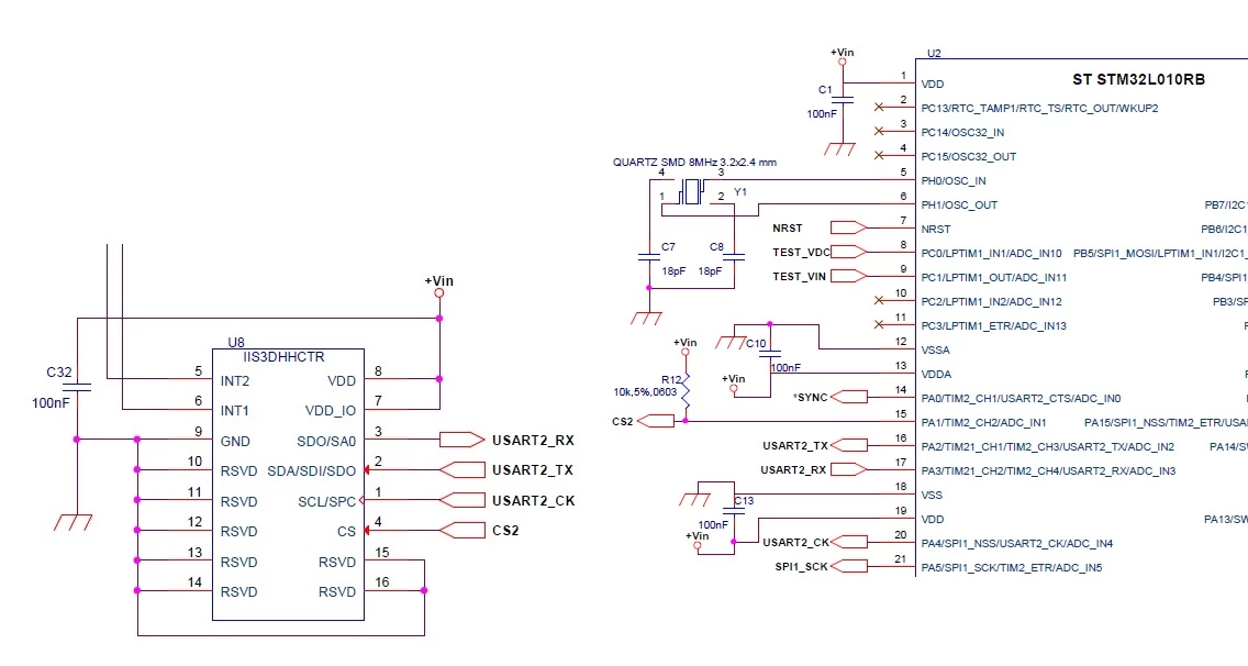

I'm using S32cubeMX to create a project for a stm32L010; on a proprietary board we connected a SPI ST mems to USART2. I have 2 questions 1) I can't select MSBFIRST bit using standard HAL drivers. 2) it seems USART2 tx/rx lines have an internal shortc
1) CubeMX create a usart type port, without opportunity to use UART_AdvFeatureConfig(); I implemented by myself the setting of MSBFIRST bit and works fine.
2) using USART2 in synchronous mode, on the read operation tx and rx lines are exactly equal and on both ones I get wrong voltage level on (using oscilloscope)

2. There are no internal shorts between pins (except on the SO-8 package - do you use such?). Check your board.

What are the hardware connections to the given pins?
AGasp.1446
Sep 3, 2020 6:57 AM UTC
here a part of the schematics and reading code

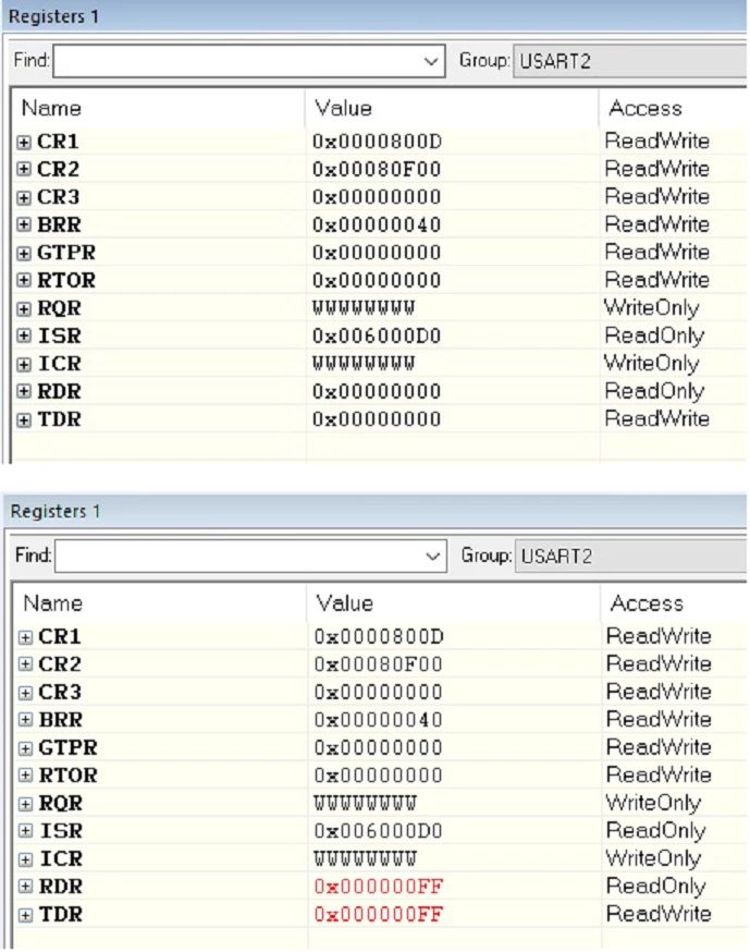

Read out and post the USART2 registers content.
AGasp.1446
Sep 3, 2020 11:50 AM UTC
here the the USART2 registers condition before and after tx/rx operation; as a 2nd byte is transmitted, in this case i wrote 0xff. If I write 0x00, RDR an TDR will be 00 in the second screenshot.0693W000003Qfq2QAC.jpg

I can't see anything suspicious here either.
Sorry but I have no more idea what could be wrong.

what's wrong is RSR register; using a oscillosciope (LeCroy 600Mhz), on the second operation (rx) I see a try to send the correct code of the mems (0x11) with wrong voltage levels, depending on the value in TDR register; both USART2TX/RX have exactly the same behaviour, so even on tx I see the same waveform of rx.
