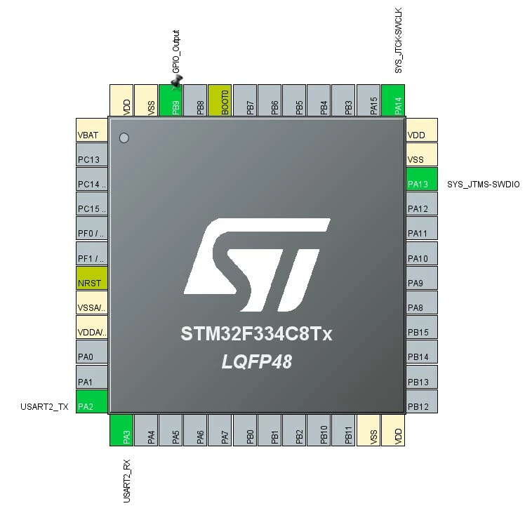

I'm trying Tutorial #4 (UART Communication) from CubeMX manual, but it does not work. I'm using a Discovery STM32F334C8T6.
I have followed scrupulously every step, but Tera Term (or other terminal emulators) does not show any sign of communication with my board. The board is a Discovery STM32F334C8T6: the tutorial is tailored to a Nucleo board, but the pinout of the two boards are very similar.
  • Select Debug Serial Wire under SYS: done;
  • Select Internal Clock as clock source under TIM2 peripheral: done;
  • Select the Asynchronous mode for the USART2 peripheral: done;
  • Check that the signals are properly assigned on pins: USART_RX on PA3, TCK on PA14, USART_TX on PA2, USART_RX on PA3, done. Although they have slightly different names on my board (for example, pin PA14 is assigned to SYS_JTCK-SWCLK, and pin PA13 is assigned to SYS_JTMS-SWDIO).
  • Go to the Clock Configuration tab and leave the configuration untouched: done. The Nucleo-L073RZ has a default clock of 2.097 MHz: i have selected 2 MHz on mine to match as closely as possible.

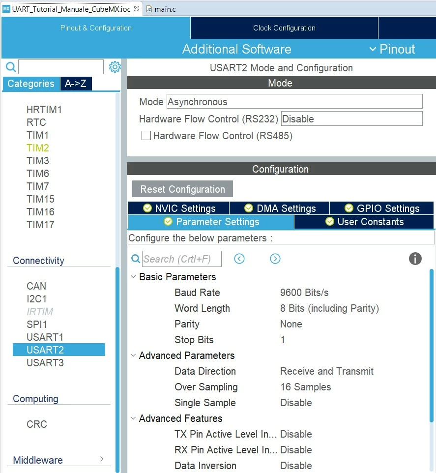

  • From the Configuration tab, click USART2 to open the peripheral Parameter Settings window and set the baud rate to 9600. Make sure the Data direction is set to “Receive and Transmit�?: done.
  • Click TIM2 and change the pre-scaler to 16000, the Word Length to 8 bits and the Counter Period to 1000: done.
  • Enable TIM2 global interrupt from the NVIC Settings tab: done.

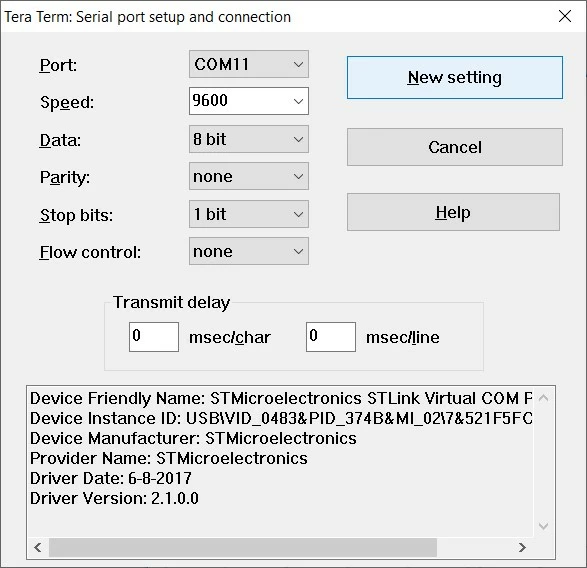

I compile under STM32CubeIDE, no errors. Enter debug mode, code is downloaded, debug mode started. Tera Term automatically discovers the board connected to COM11 port, with the correct settings, but it does not show any message incoming.

GammaSigma
Mar 2, 2020 6:37 PM UTC
Thank you for your kind reply. Unfortunately I'm still a learner, so please bear with me: I am unsure about what you mean when you say that there should be a UART to USB conversion through the STLink on board the Discovery. I have read on the manual that USART2 is physically connected to the Discovery's USB port, and I have activated USART2 on the peripheral list, in Asynchronous mode and with the suggested settings (which, by the way, are the same as Tera Term: Baud Rate 9600, Word Length 8 bits, no parity, 1 Stop Bits, Receive and Transmit):
This is the pinout, as suggested by the manual:
I have activated the green LED as well, to verify the Callback function. I have followed your suggestion, and tried to send a single character instead of a string:

Whenever the timer2 sends an interrupt, the green LED toggles, so this proves that the Callback function works. But, again, the terminal windows stays silent:
Thank you for your patience.

GammaSigma
Mar 2, 2020 7:36 PM UTC
Thank you for your reply. Yes, the correct COM port number is 11: I had simply selected the wrong pins, PA2 and PA3 instead of PB3 and PB4. Now everything works fine.
