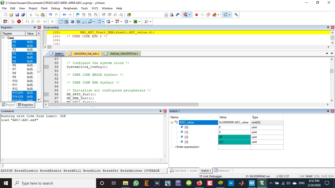

i'm trying to read 4 analog input by ADC using DMA and cubemx to make my code . the first two values is reading correctly but the others can't read them in any way . plz any idea

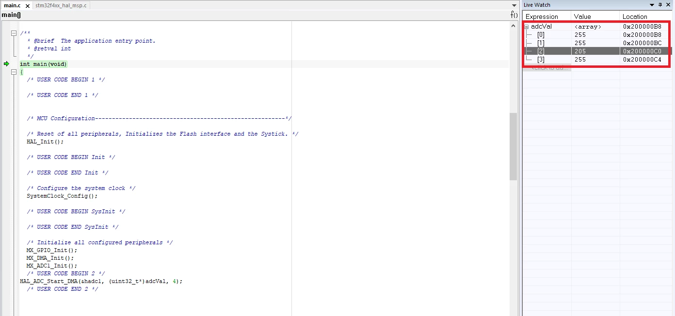

I have made a test to check and I don’t have any problem, as shown in Figure (when using IAR)
I used: PA0 ------> ADC1_IN0
             PA1 ------> ADC1_IN1
             PA4  ------> ADC1_IN4
             PB0  ------> ADC1_IN8
You will find attached my file STM32f7xx_hal_msp.c and main. c
Regards
