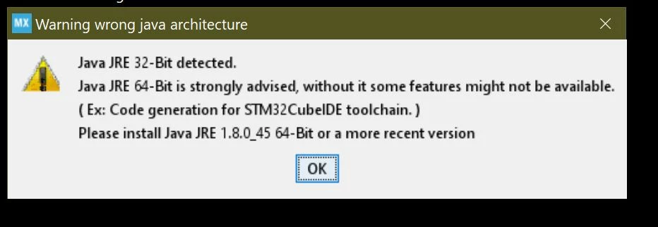

I'm getting this message when I open STM32CubeMx version 5.6, but I have the latest version of java which is 1.8.0_251. see image 2. I don't know what's the problem? Does anyone knows what's going on?

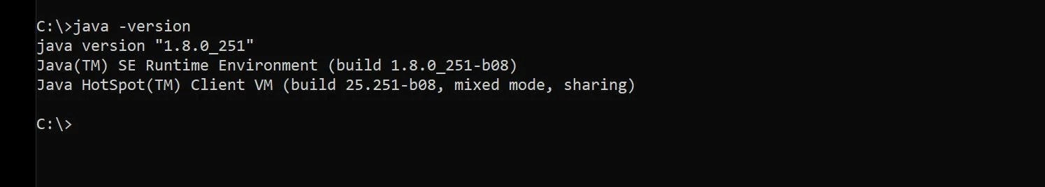

This is the warning I got when I open the CubeMx:
This is the Java version install on my laptop. When open the "cmd" to run the command: java -version. 0693W000000WXrlQAG.jpg
As you can see I have the latest version of Java, which is a 64-bit. I don't see how the CubeMx software detect a 32-bit,
FYI: I did what you suggested before I posted on the forum.
Tom
BTrem.1
Senior
Apr 29, 2020 10:56 PM UTC
I don't think that is 64-bit.
My install says this:
Java(TM) SE Runtime Environment (build 1.8.0_251-b08)
Java HotSpot(TM) 64-Bit Server VM (build 25.251-b08, mixed mode)

Thanks! I see the problem.
I had to uninstall the Java 8.0_251-b08
and download a Java: jre-8U251-window-x64.exe from
https://java.com/en/download/manual.jsp
to resolve my warring message.
My assumption was the latest Java version 8 update 251 was the latest and I read somewhere on the website it was a 64-bit. I was wrong.
Thanks for all the help and point me to the right direction.
