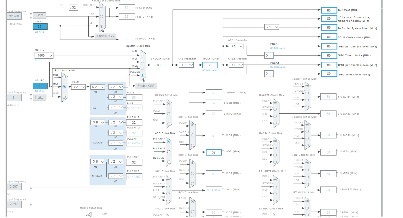

I'm a STMCube Newbie. I'm under the impression when I set up the clocks in STM32CubeIDE, it should generate all the clock configurations. Right now I'm not getting the RCC_PeriphCLKInitTypeDef PeriphClkInit = {0}; Should it be there. See clock config

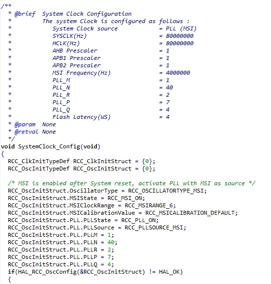

After configuring the Clock tree in stm32Cube and generating the code, you shall find something like this
the RCC_PeriphCLKInitTypeDef PeriphClkInit = {0} functions is used to configure all peripherals clocks settings, such as frequency and prescaler. It is important to understand that all peripherals need to be properly configured to receive the correct clock frequency.
Hope that helps!

Your image is what I get. But I was expecting this as well:
void SystemClock_Config(void)
. // whats in your image plus vvvvvv
PeriphClkInit.PeriphClockSelection = RCC_PERIPHCLK_ADC;
 PeriphClkInit.AdcClockSelection = RCC_ADCCLKSOURCE_PLLSAI1;
 PeriphClkInit.PLLSAI1.PLLSAI1Source = RCC_PLLSOURCE_HSI;
 PeriphClkInit.PLLSAI1.PLLSAI1M = 2;
 PeriphClkInit.PLLSAI1.PLLSAI1N = 8;
 PeriphClkInit.PLLSAI1.PLLSAI1P = RCC_PLLP_DIV7;
 PeriphClkInit.PLLSAI1.PLLSAI1Q = RCC_PLLQ_DIV2;
 PeriphClkInit.PLLSAI1.PLLSAI1R = RCC_PLLR_DIV2;
 PeriphClkInit.PLLSAI1.PLLSAI1ClockOut = RCC_PLLSAI1_ADC1CLK;
 if (HAL_RCCEx_PeriphCLKConfig(&PeriphClkInit) != HAL_OK)
  Error_Handler();
What reference should I use on what to add to the generated code (like this) for other clock configuration details?.
